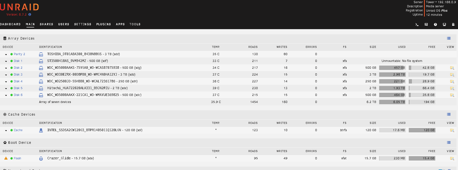

unmountable: no file system - help request
i turned on my server to find this help
can i just swap out the drive with a new one and i have no backups because i am broke

so did i lose those files or did it recover them
and everything mounted fine after
Edited by bobingtion
Check lost+found folder, any lost/incomplete files should be there.
no lost+found folder so i am good thanks
