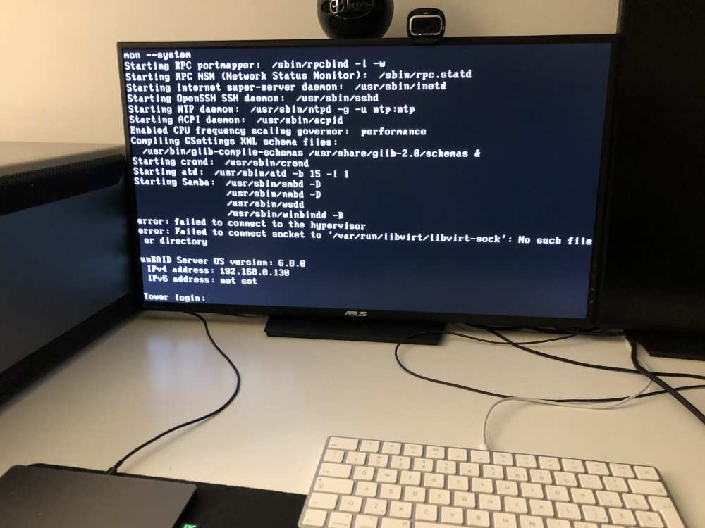

Would anyone know why I get the following errors during boot:
error: failed to connect to the hypervisor
error: Failed to connect socket to '/var/run/libvirt/libvirt-sock': No such file or directory
Post diagnostics
