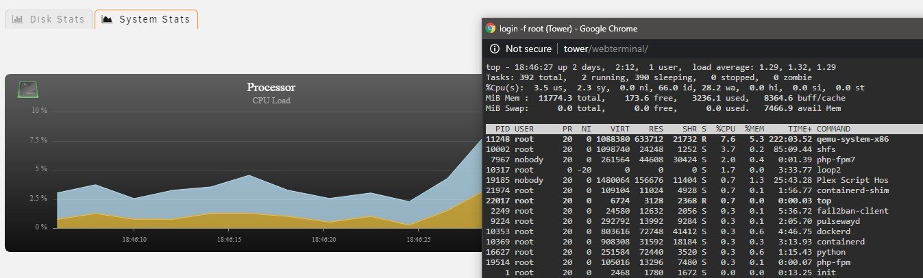

Only noticed this now.... on the Dashboard view, CPU 0 is pegged at 100% usage.....but Stats and top shows that the usage is normal...?959900437_CPU0usage.jpg.ad196ba838933e518887d45479590647.jpg2100740984_statsandtop.thumb.jpg.97d13f8d4e7cf69385c7e84aafe5ab9f.jpg
EDIT: I stopped all VM's and Dockers, but still shows CPU 0 at 100% usage....
you can see your load is 1.x which aligns with one of the cpus being pegged. your not showing all the processes in top.. try: top -b1
