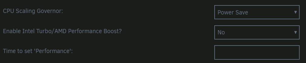

I think that the issue was coming from the Tips and Tweaks CPU governer settings. I originally had this set as Performance and Enabled the Intel Turbo Boost and have reset it to default. It seems to be working ok for now.
