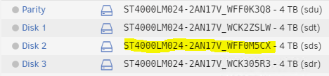

They are not stored, sdX can and will change and that's not a problem, but if the disk id string changes (model + serial) Unraid will consider it's a different disk and complain, by id sting I mean just the highlighted part:
This can change with RAID controllers, USB enclosures and some DAS enclosures, but like I mentioned I'm not sure the NetApp changes that as I never used one, it's easy to try and check.

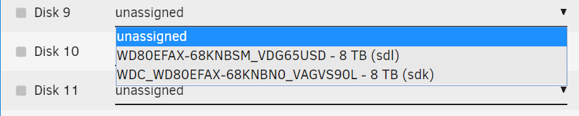

I have finally been able to test the disk id strings between the motherboard SATA connectors and the NetAPP device connected via SAS cable to the same computer running unRAID.  The test disk showed up as per PIC1 below, and the same disk showed up as per PIC2 below when connected via the NETAPP device.  It looks like the SATA controller method via the motherboard appends the WDC_ to the front of the disk id.
Does anyone know of a way where I can move the disk from one location to another and inform unRAID that even though the disk id changed, that disk 8 is in fact a specified disk regardless of the disk id?
Is there a way where I can assign the disk ids myself rather than let unRAID do this for me?  Would this be a feature request for advanced users?
I will test one the Ironwolves next to see if they behave the same way, but I expect they will.
I do have a backup of the configuration as well as a full screenshot of the disk ids as they exist now.
