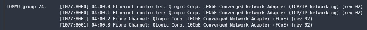

In case someone stumbles here, wanted to report that I am successfully running the card in my NAS with both 10Gbit interfaces in adaptive load balancing and have no issues.
Can you confirm if the device you have has pci product id 0x8000 or 0x8012?
It can be checked with `lspci -vnn`. All such devices I've seen so far have id 0x8012.
Thanks.

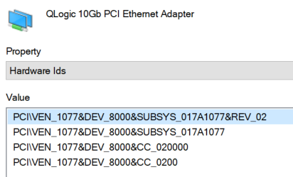

Sorry for being super late here, it's 0x8000, checked both unraid and windows.
No problem, no rush on my part. Thanks a lot for the detailed info. Actually, I doubled-checked and the adapters I worked with in the past were also 1077:8000 (and also subsys 1077:017A), my bad I'm sorry. It's the other way around, I've never seen 0x8012! I thought that the IBM-branded OEM adapters might have a different id. The same driver (qlge) registers support for both ids.
