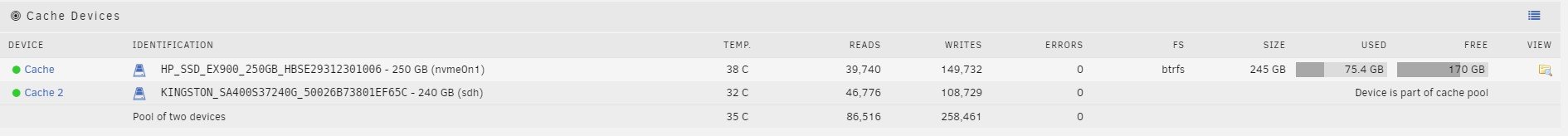

I was told that I could add an additional cache drive just like adding an additional pool drive. It did not seem to work. and unfortunately my appdata was stored and backed up on cache.
As of now I have no dockers, and it looks as though the appdata backups that the system said was on disk 3 were on cache.
is there any way to get the system to accept the original cach drive? it was not formatted.
You can only if current cache was btrfs, you can't with for example xfs, if it was btfs please post diags: Tools -> Diagnostics

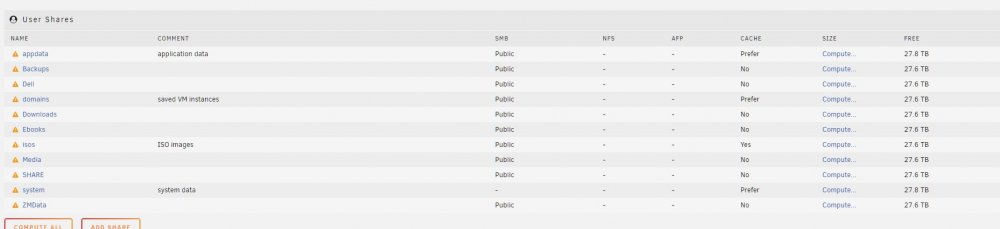

I now need to make sure that my cache  share setting are correct.I think.
I have orange warnings on all of my shares saying that they are unprotected.
That's normal for any single device cache.

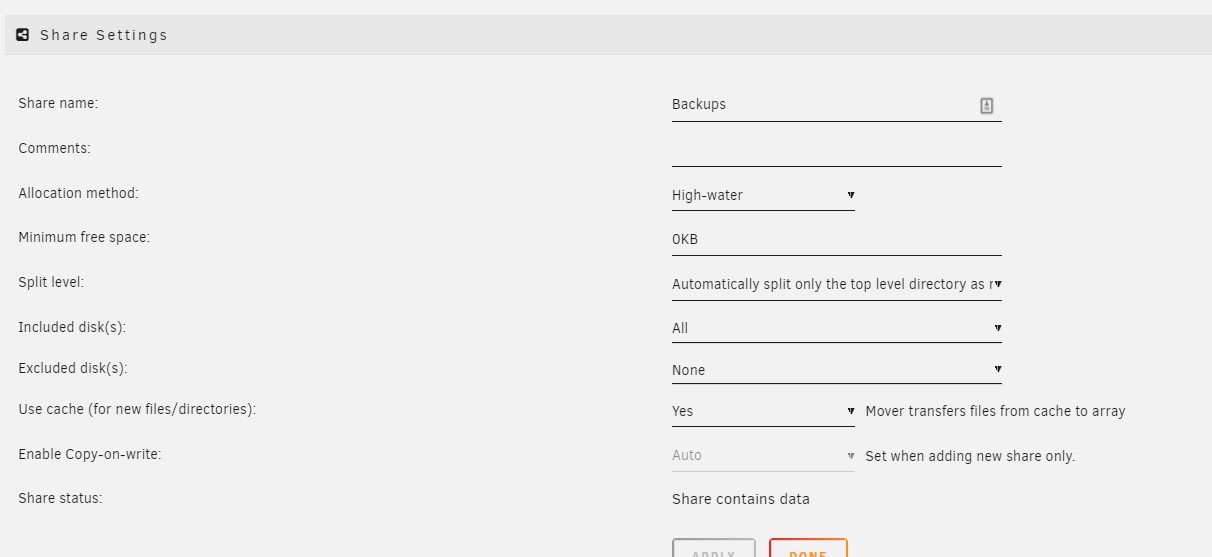

So how do I add additional cach. When I do an appdata backup, it is saving on cache.
I think that the Yes in cache setting is the issue but I'm not sure
Having Yes would initially save it to the cache, but when mover kicks in copy it to the array.
what you probably want to do is manually run mover to get the backup files onto the array, and when that completes change the Use Cache setting to No.
I have successfully added a second cache drive but still see the orange warnings?
Am I missing something?

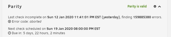

Is your parity valid?
It says it is, however the last check was aborted, should I run a check?

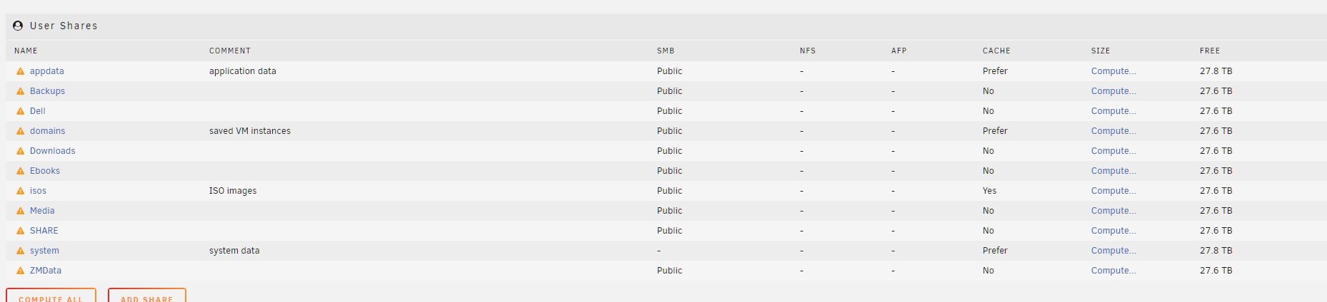

Please post the diagnostics: Tools -> Diagnostics
Disk17 is disable, so all shares on the array are currently unprotected (if another disk fails).
How do I remove that disk, there was nothing on it?
Chas
Thank you, I followed the instructions and the drives are removed, now in 17 hours, I'll see if it fixes my issues (parity rebuild 17 hrs)
