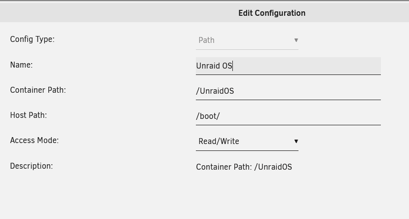

I have configure the USB (unraidOS) into the docker like this in duplicati

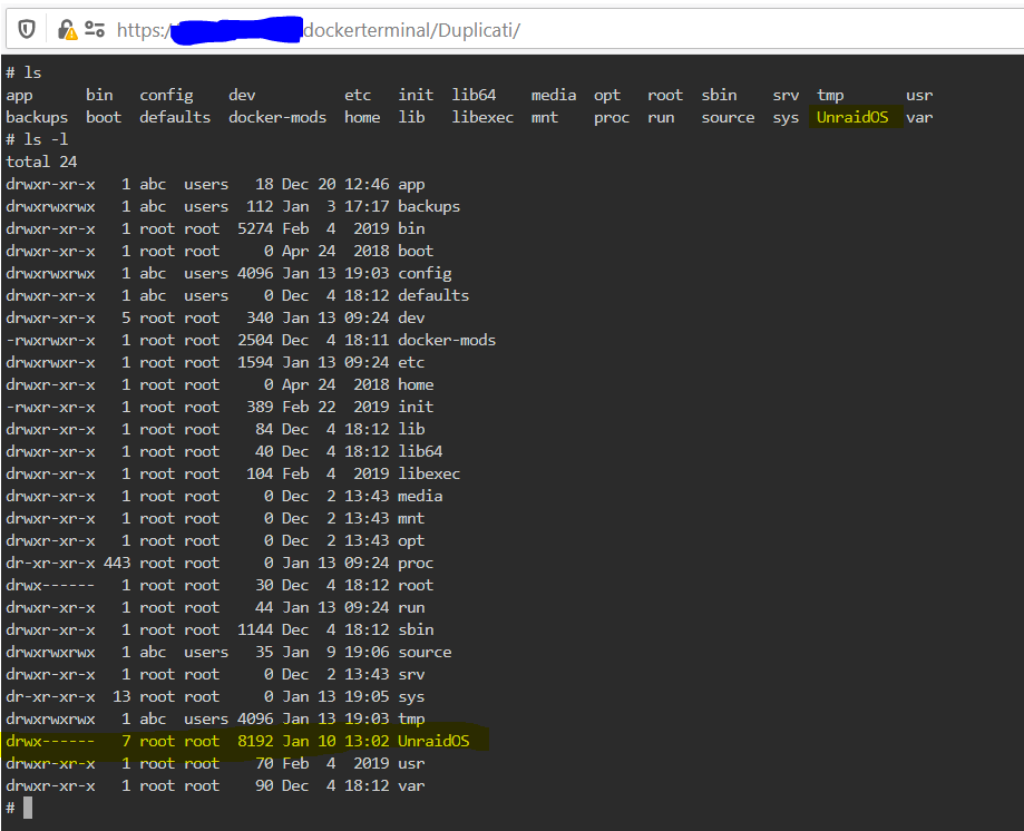

When I try to run a backup of it I get an error from duplicati because it can't read files
The permisions of the folder from duplicati docker command line like this
How can I give read permisions to the docker to be able to read the files a do the backup?
I do not believe you can change the permissions on the /boot device, so the docker would have to be running as 'root' to access it's contents.
