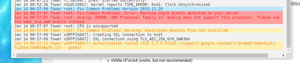

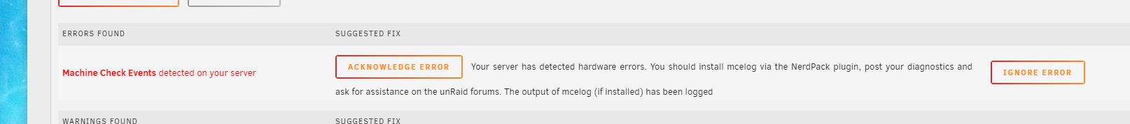

Got this just a while ago, via fix common problems, then I checked my syslog and got that my cpu is unsupported

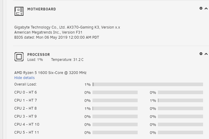

.I have a ryzen 5 1600 six core @3.2Ghtz.....unraid wiki says its ok
I have a 600w Thermaltake PSU, 2x8Gb DDR4 (3200Mhtz) Ram, Samsung 970 Evo Nvme ssd &  2tb seagate hdd

It is, but Ryzen on Linux can lock up due to issues with c-states, make sure bios is up to date, then look for "Power Supply Idle Control" (or similar) and set it to "typical current idle" (or similar), or completely disable C-sates.
More info here:
https://forums.unraid.net/bug-reports/prereleases/670-rc1-system-hard-lock-r354/
