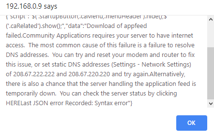

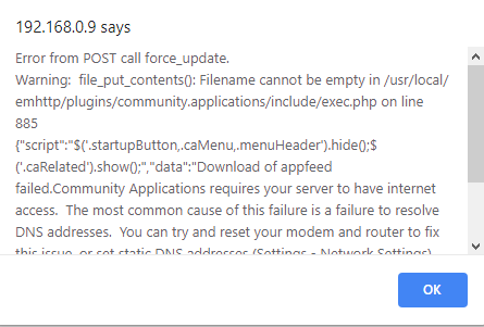

The message that is given when trying to access the unraid apps, sorry it wouldn't let me copy the text so i attached as images
Yeah, known issue with that rev.  Update community applications via the plugins tab and then we'll go from there.
But, since you've got a new router, what is it's IP address?  The server wasn't using DHCP and has a static IP of 192.168.0.9 but if the new router doesn't have and IP of 192.168.0.1 then you're going to have a ton of problems.
