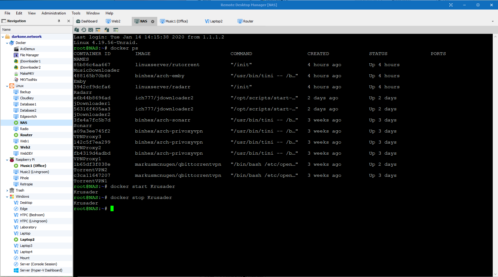

So i've setup my Remote Desktop Manager (which is a wonderful windows program by the way to keep all my remote stuff in one place) to run a cmd plink script that ssh's into my unraid installation and starts the Krusader docker container.
Then after 5 seconds has passed it initiates the actual vnc connection to the now started docked container.
When i exit the vnc connection it sends another cmd plink command to stop the Krusader container.
This all works fine, but i have to pass the password in clear text using plink and i use the root login which feels bad.
My question to you is: How do i setup a user that i can ssh in to unraid with that ONLY has permission to stop/start manage the docker containers and not the rest of the unraid installation? I would rather use a limited user that only has these privileges than using the root account.
