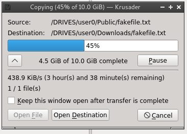

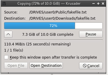

When copying from one array folder to another, the transfer fluctuates wildly over the duration of the transfer, going from as low as 438.9KiB/s and to as high as 110.4MiB/s as seen below (Array1 & Array2.png)

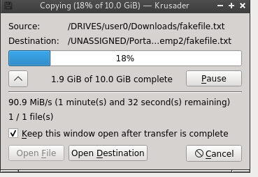

Copying the same file to the USB 2 connected drive, gives a transfer time of 03:28 for a 10GiB file and generally copied across at 43GiB/s but did peak at the start to 90GiB/s, as seen below (USB Start.png)
I understand the typical HDD has a memory buffer which is why the speeds are greater at the start, but the wild fluctuations when copying from one array folder to another seems like it is filling the buffer and then emptying and just cycling through that process. Is there anything to help smooth it out?

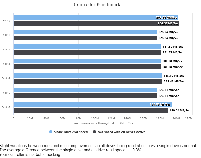

Running the controller benchmarking in Diskspeed indicates the SAS controller is good and the disks perform well.
