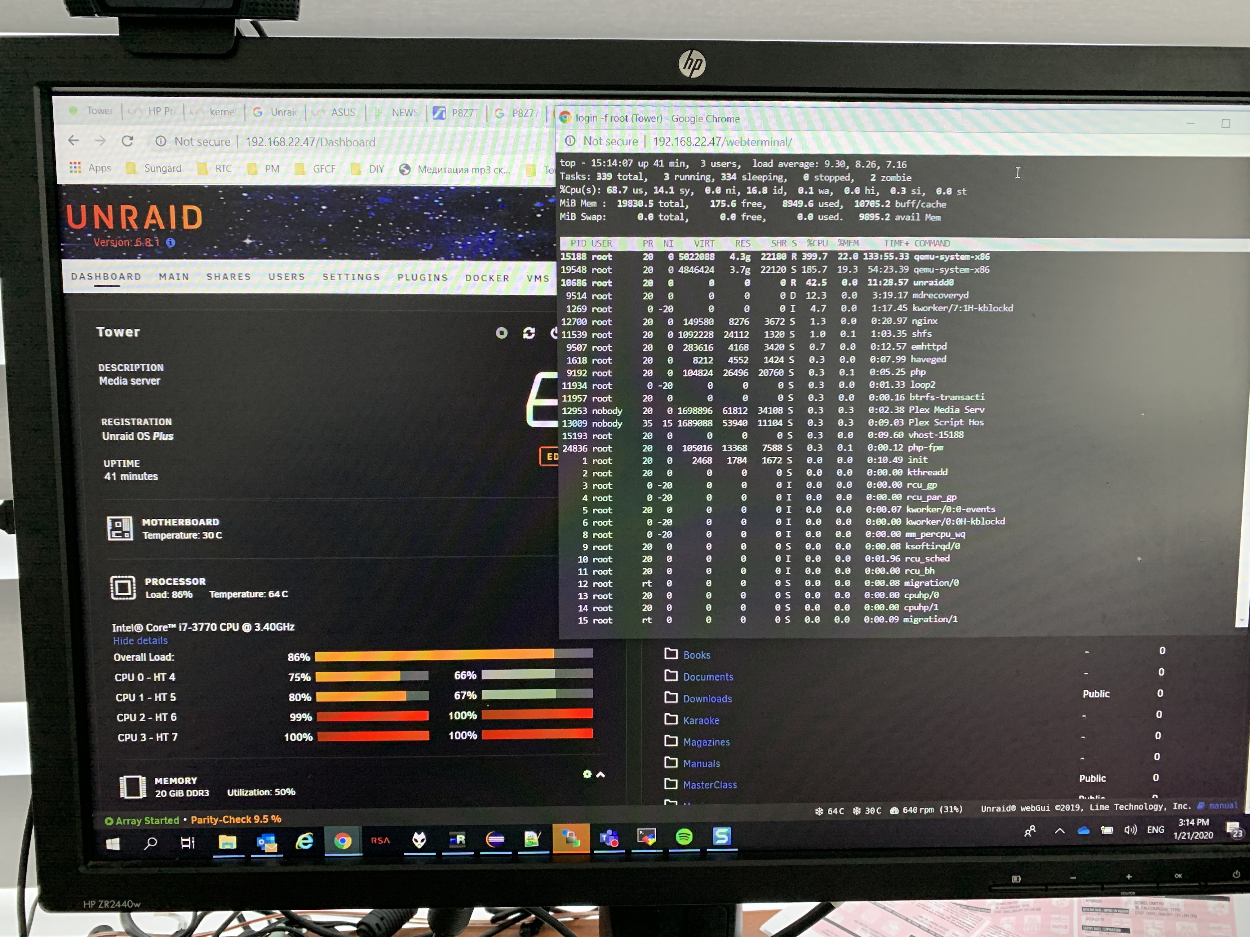

I see fast grow in zombie processes visible from top. around 100 in 5 mins. Could this be a problem?
I localized a source of zombies to specific container. The problem started before I implemented the container. So, seems irrelevant.

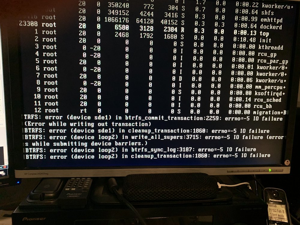

Up to the moment I tested all components, besides MB. The test is upcoming. I was able to catch once a failure on a console. Screenshot attached. Attaching cumulative syslog as well. Would appreciate your thoughts.
