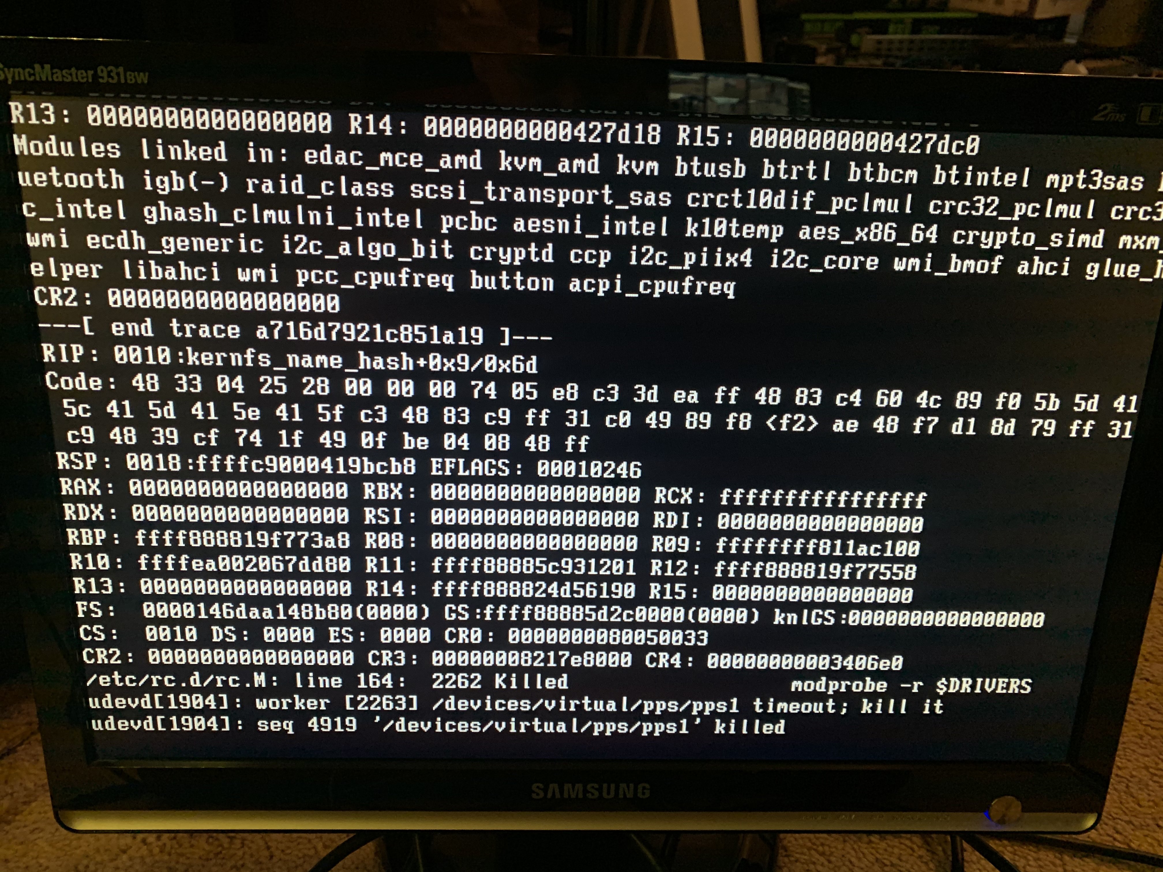

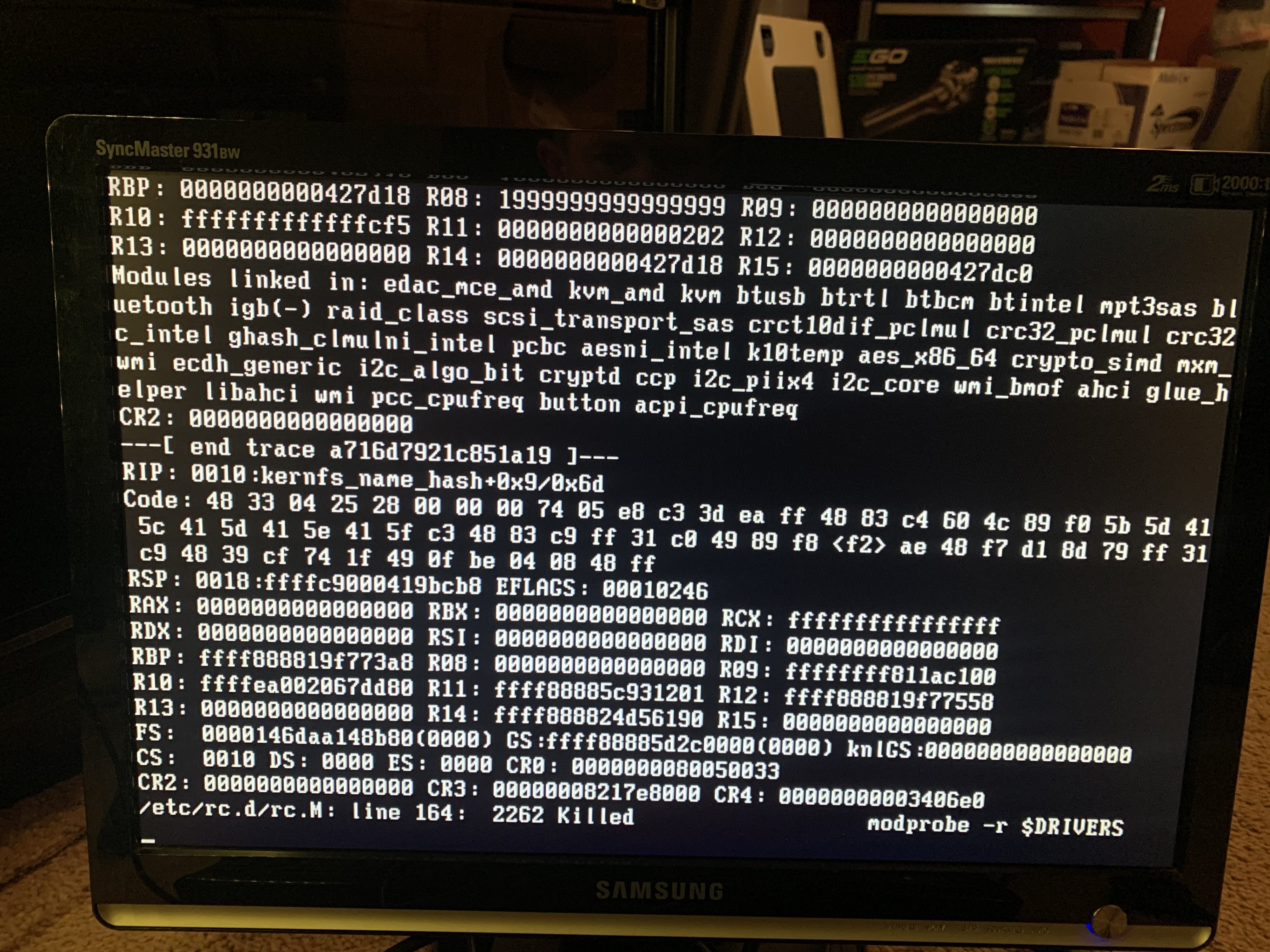

After I updated Unriad from 6.8.0 to 6.8.1, my system hangs during boot up. I'm getting an error of /etc/rc.d/rc.m: line 164: 2262 Killed and worker [2263] '/devices/virtual/pps/pps1' killed
Does anybody have an idea how to fix this issue? I had no problems with version 6.8.0

Ok, I'm still getting the error messages regardless if I boot into safe mode or not. I have rebooting my system multiple times and sometimes I will get the error message. Its sporadic.
My system was 100% stable under version 6.8.0.
Do I need to submit a bug report? My hardware is a Threadripper 2920x and a X399 Taichi

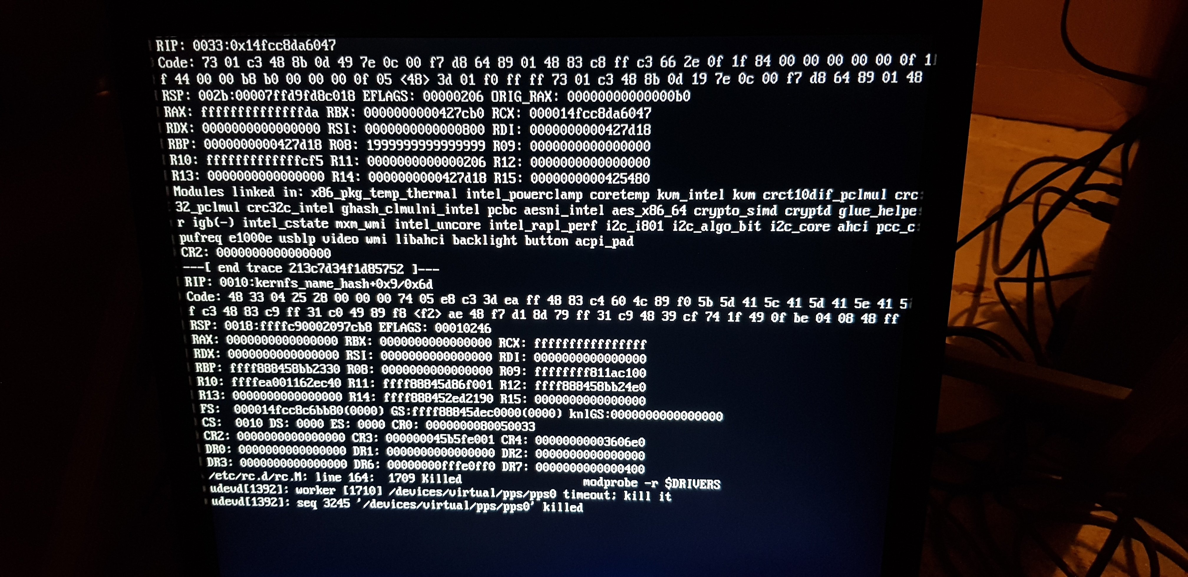

Same issue here on a Asrock C236 WSI.
System goes out sporadically. Sometimes reboots or hangs (no Video, CPU fan off). If he does not go out, said messages appear.
