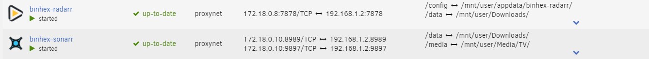

brawny,
thanks for the info, but that doesn't seem to help for me, I'm running radarr, sonarr and sabnzbd in dockers using proxynet.
sabnzbd shows local as 172.18.0.4 for the past 2 years sonarr and radarr have used 192.168.1.2.
Not sure what changed.
thanks tho
Chas

brawny,
My bad, it worked once I corrected the api key as well.
Thanks for the save!
Chas
