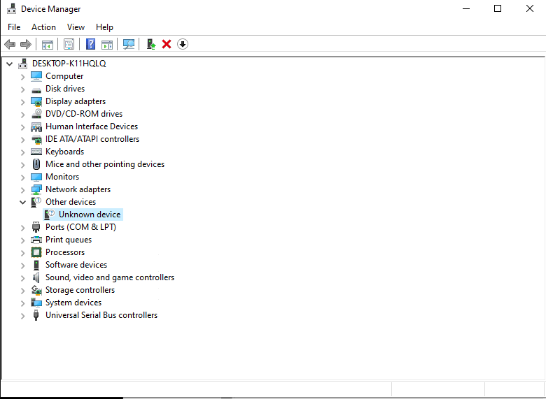

January 17, 20206 yr Hi all new install of windows 10 and i have an unknown device in device manager. Device id is in the title. No matter what i try cannot find the right driver for this. Any thoughts please? No other usb or other devices passed through so its not that. Edited January 18, 20206 yr by AntaresUK
January 18, 20206 yr Author Turned out it was system devices> ACPI Processor container device This is on 2950x

September 22, 20206 yr On 7/2/2020 at 5:33 AM, AntaresUK said: Its under update driver, then "browse my computer for drivers", then "let me pick from a list of available drivers for my computer" then show system devices, then the acpi driver is on the list on the right hand side. I had the same problem. Glad I found your post. FYI its under (Standard system devices) from the left tab. So how do you know it's ACPI Processor container device??? After I did what you've suggested, the device remains in the Other devices -> Unknown device

October 19, 20206 yr On 9/22/2020 at 4:19 AM, DrJake said: I had the same problem. Glad I found your post. FYI its under (Standard system devices) from the left tab. So how do you know it's ACPI Processor container device??? After I did what you've suggested, the device remains in the Other devices -> Unknown device I did the same and resulting in same image... did you find a resolution to your issue? Thanks!
November 8, 20205 yr On 10/20/2020 at 12:30 AM, xxxliqu1dxxx said: I did the same and resulting in same image... did you find a resolution to your issue? Thanks! nope. I decided to not worry about it
November 10, 20205 yr I found the Driver he's talking about Browse My Computer Let me pick from list System Devices *then the missing step above* On left do (Standard System Devices), Then on the right "ACPI Processor Container Device" This gets me to AntaresUK's solution, of selecting the driver he specifies that people couldnt find. HOWEVER, I still get the different icon, but still "Unknown Device" shown by DrJake. So its not a true resolution.
