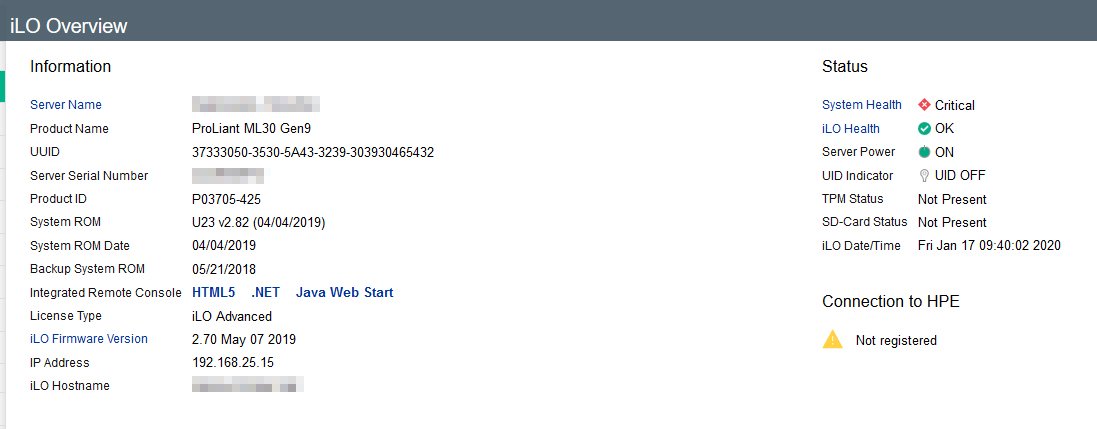

This is what is happening on the brand new ML30 (G9), which is essentially the same on all three HP variations... the symptoms I get are that when the server boots, if I am logged into the Remote Console remotely from ILO, I have no keyboard/mouse... so I cannot get past the login screen. On the front of the server I get a red LED flashing, which indicates an issue with the machine. When I log in to the ILO console I see a System Health - Critical warning;

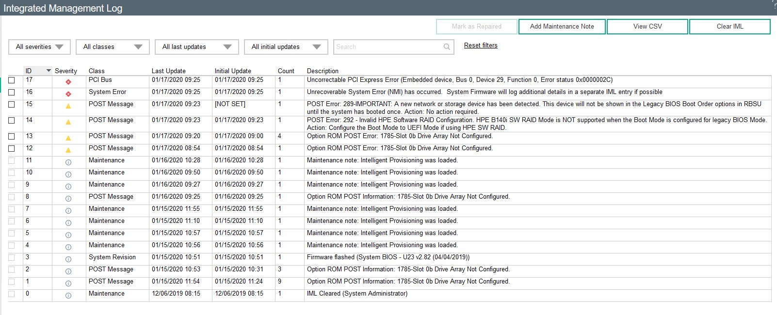

When you interrogate the management log, it tells you that there is an Uncorrectable PCI Express Error;

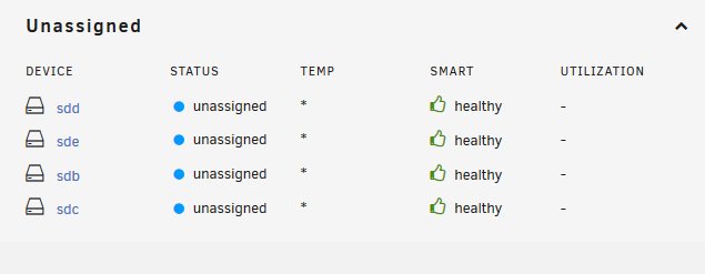

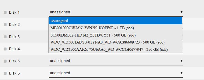

Just for completeness, the trial USB key was created using the UnRAID key creator and as the server wouldn't boot into UnRAID in its default UEFI mode, I have switched it to Legacy boot. The onboard B140i controller is not configured and there are 4 x SATA hard disks installed. These are all recognised within UnRAID;

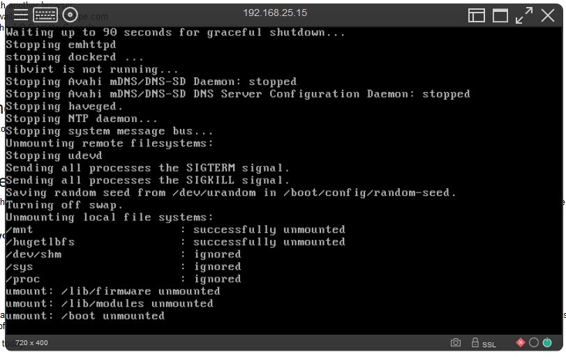

OK, a quick addendum...

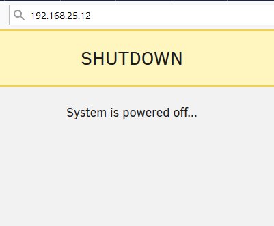

I tried to shut the stock ML30 G9 down from the UnRAID console and it counted up and then told me the machine was powered off...
But the machine is still powered on and the screen shows this...
But it has failed to shut down!
So, I will have to force it down 😞

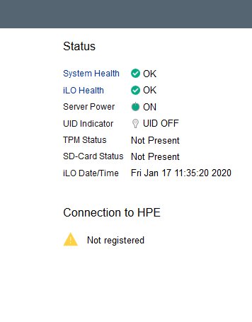

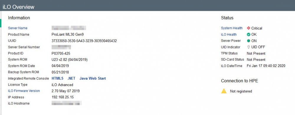

I just forced the machine to power off and the 'critical error' remains as showing in the ILO (seen this before), so I removed the power and pressed the power button to clear all residual voltage in the system, then reconnected the power and all is back to normal on the ML30 G9 (at least until I try booting UnRAID again);
