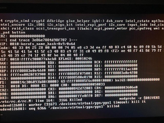

After a successful update to 6.8.0 / -1, the computer boots correctly with my DVB cards..
All tuners and HDs are available, everything works normally.
Hard disks go into standby after 15 min (I have set this) and remain so,
the IP monitoring in the network (S3 SleepPlugin) also works. unraid goes to sleep.

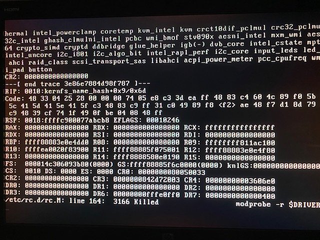

When waking up works, for a short moment is unraid there, the webui will updated.
Then the computer shuts down (apparently uncontrolled) and goes out.
Uncontrolled because my Flashdrive no longer boots!
My Flashdrive can be repaired and then rebooted.
But only once :( The whole procedure starts again!
I will probably have to stay on 6.7.2. (Downgrade over the DVB device versions is not a problem)
