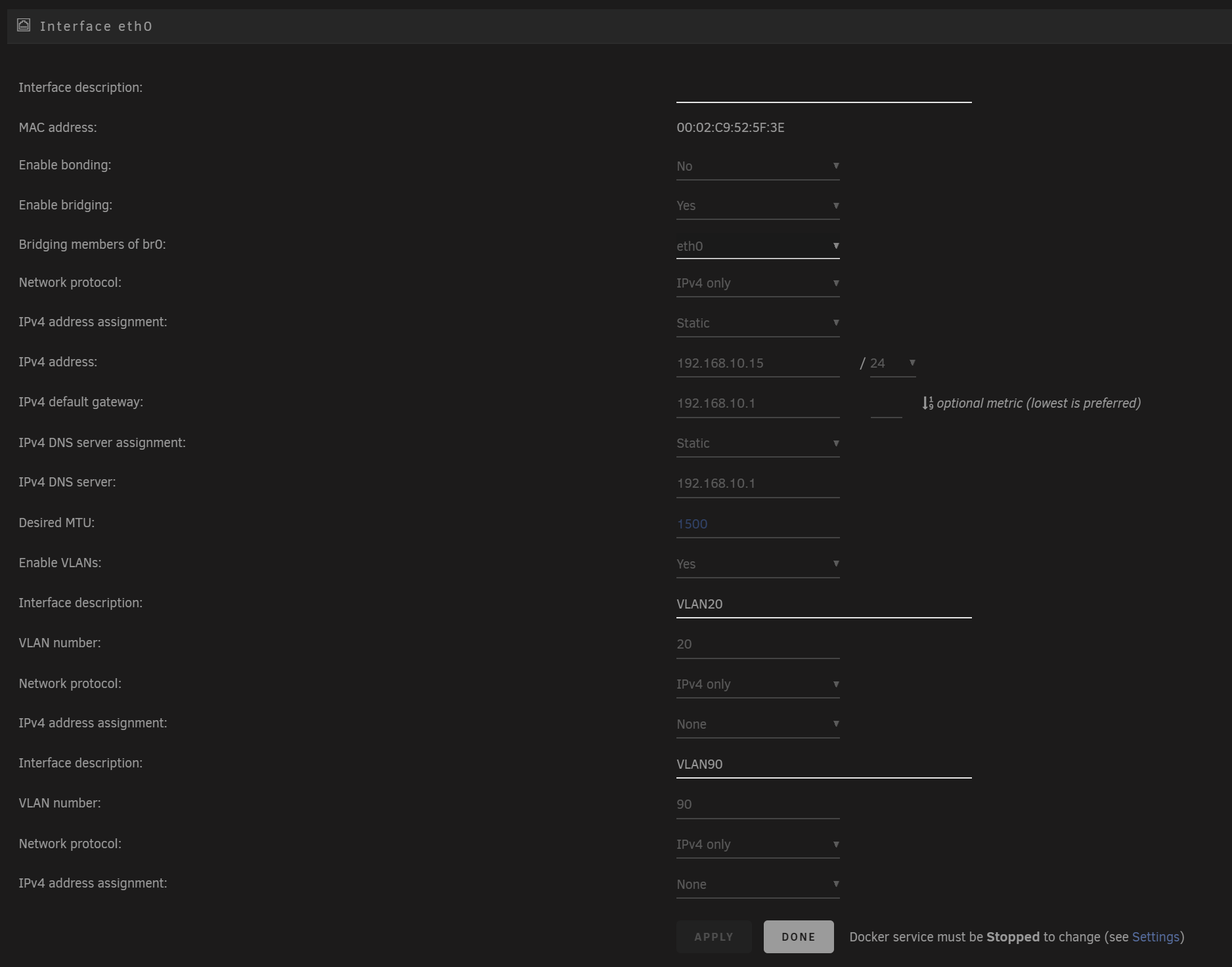

eth0 = 192.168.10.19 Dockers are run in bridge mode as well
br.90 = VM 192.168.90.22
I can currently curl 192.168.10.19 and get the header however I can not curl any of the docker ports on the same ip.

I'll give that a try.  just seems weird that it isn't routing via the switch when it should be.  it's like unraid is snatching it up trying to route it and failing to do so.
Ok, seriously stuck on this now.  I have given the dockers their own network in hopes it would allow it since its no longer the host ip.  Its still not working.
Edit:  I have for the time being been able to get a hardware nic passed through.  I feel as if this is a banded for what i need to do as i am now limited by the ports i can pass through.
