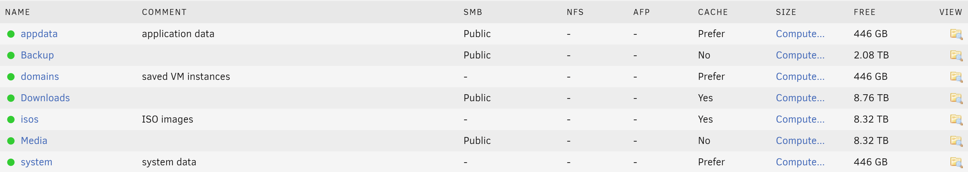

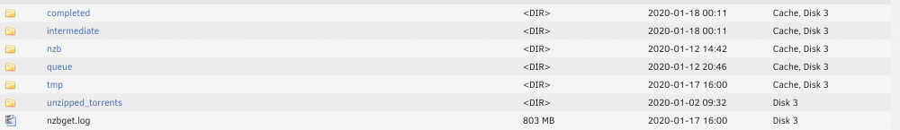

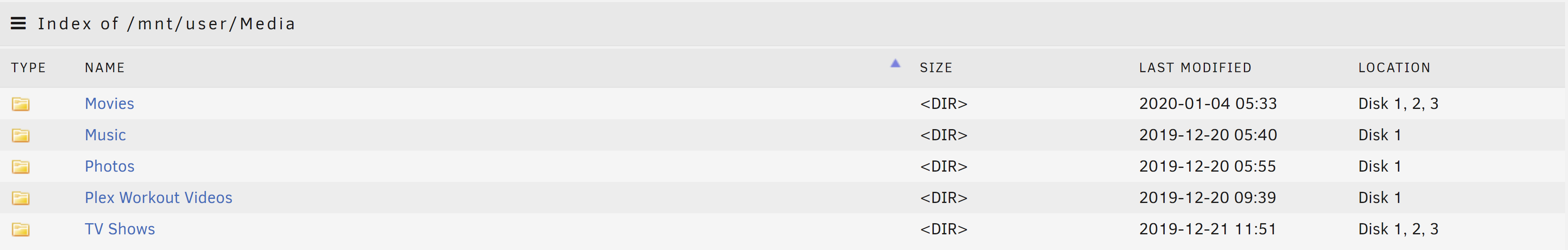

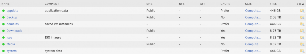

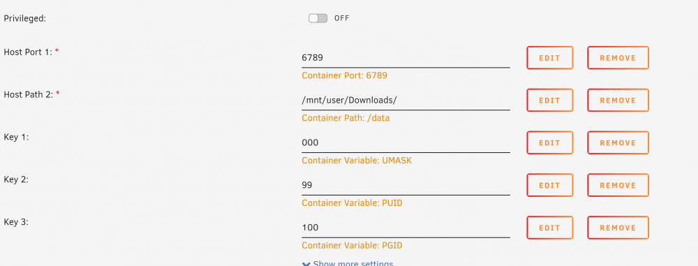

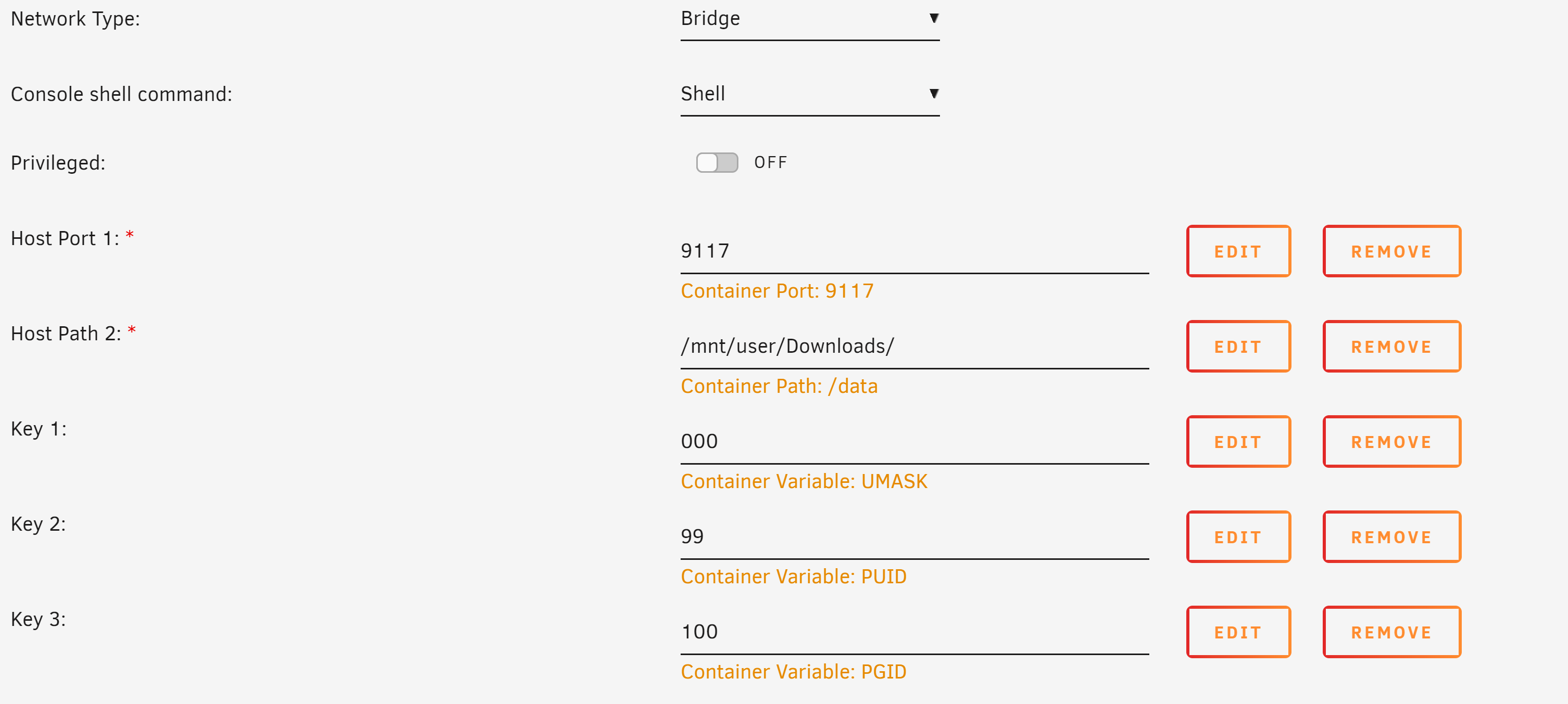

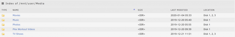

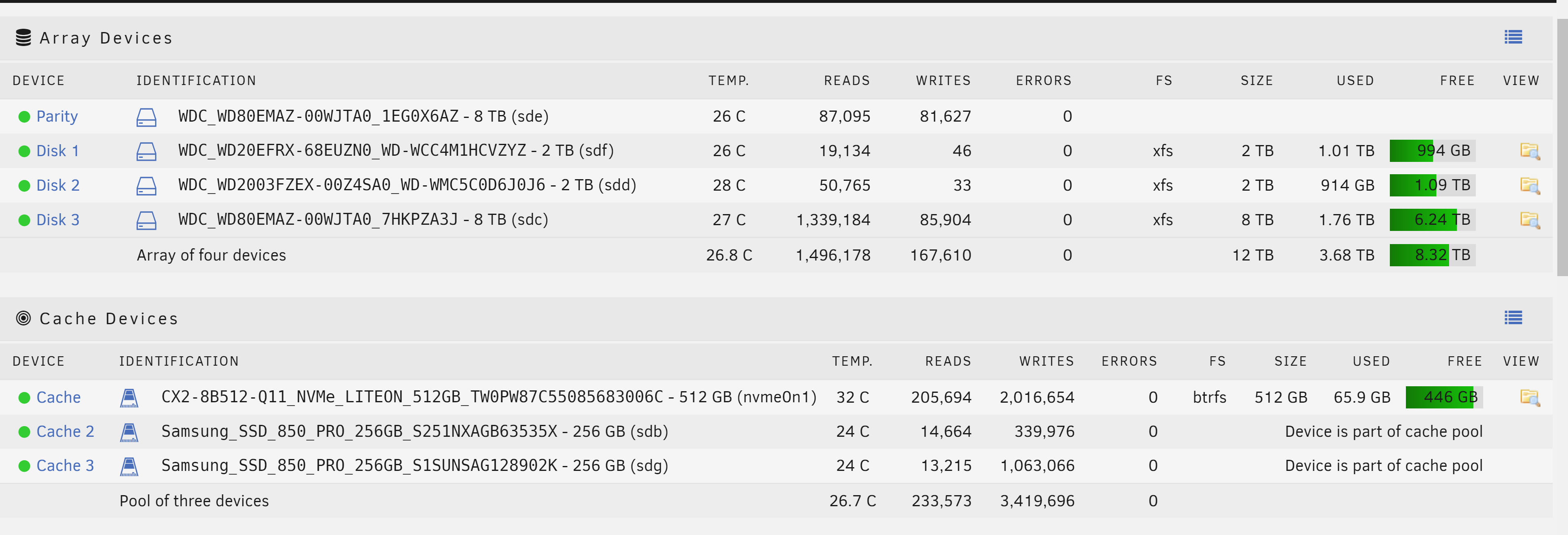

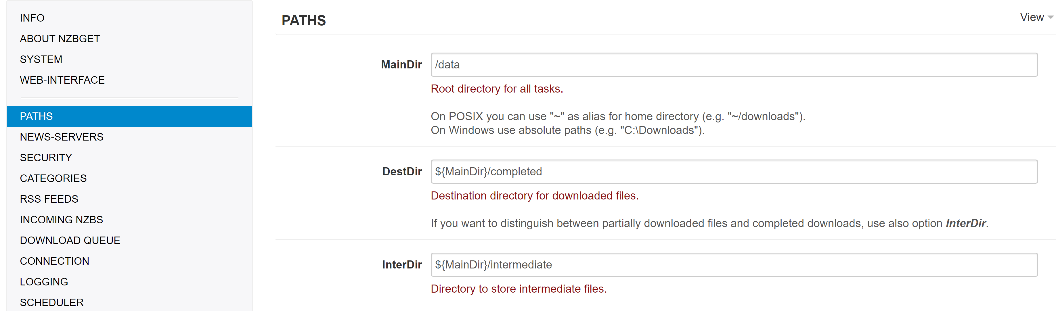

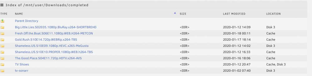

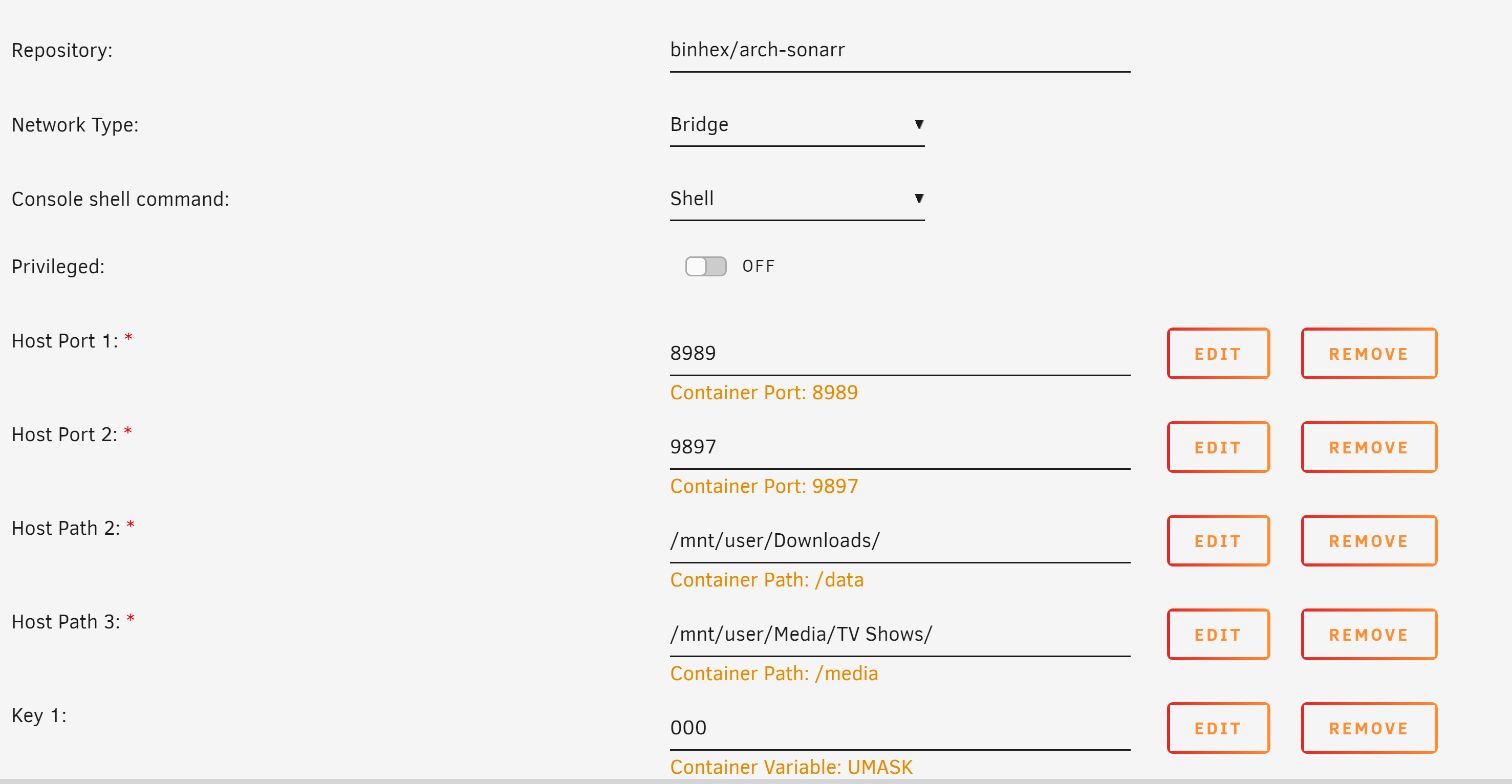

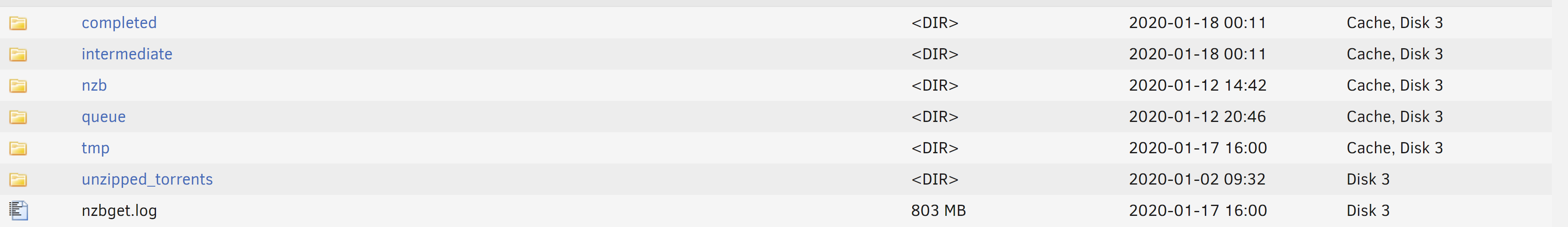

Im having issues getting my file path correct. It seems my deluge downloads will not transfer to the correct folder. My goal is to have all downloads map to my media folder and then to the respective sub folder (movies, tv etc). Ive followed a bunch of space invader videos but obviously I am missing something. I am fairly new to all this so can someone please give me a hand in taking a look at all the file paths below and let me know where I went wrong. I could really use some help and am hoping the community can get me up and running!

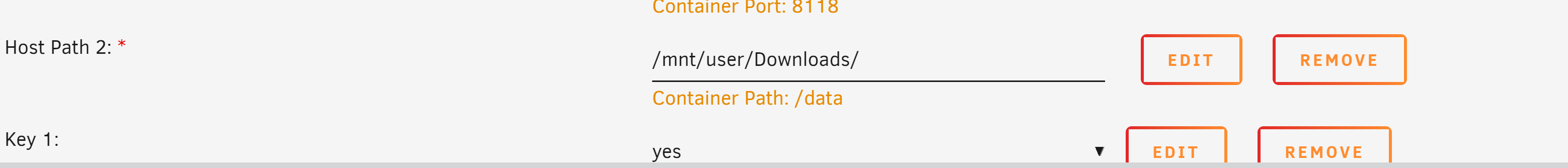

Deluge File Path:

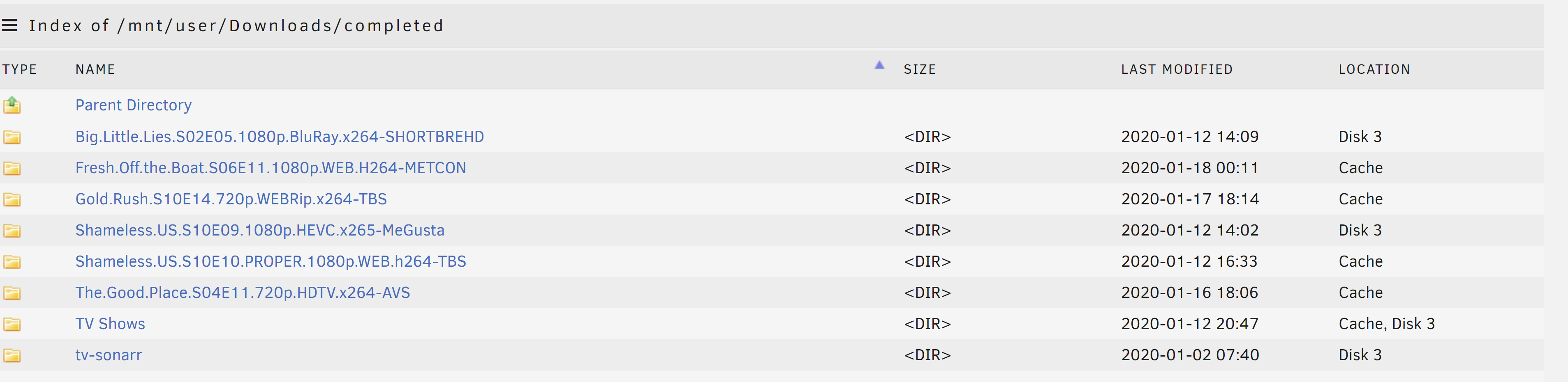

Downloads Folders:
Downloads Completed Folder:
Array Devices:
Jacket Settings:
Media Folder:
NZBGET Settings:
Shares:

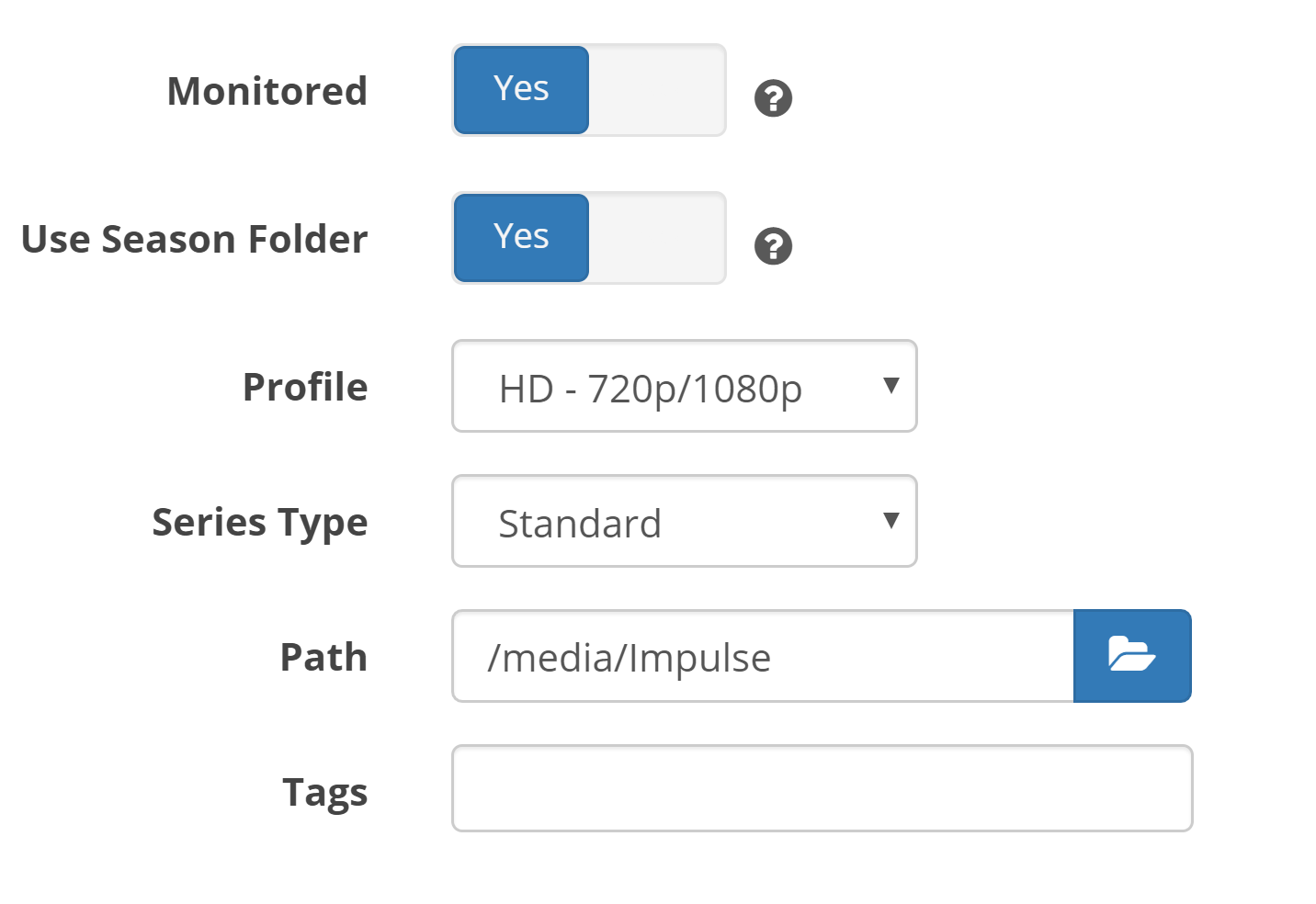

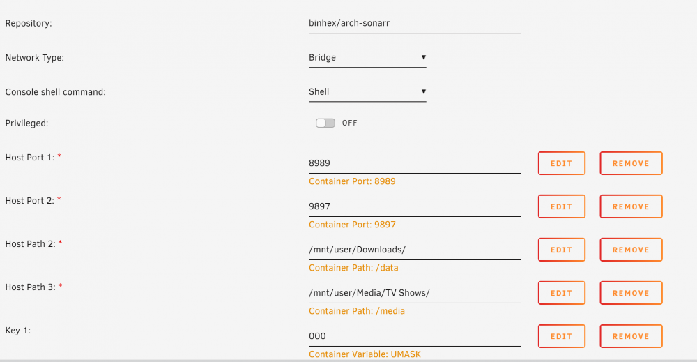

Sonnar Settings:
Sonnar tv path:

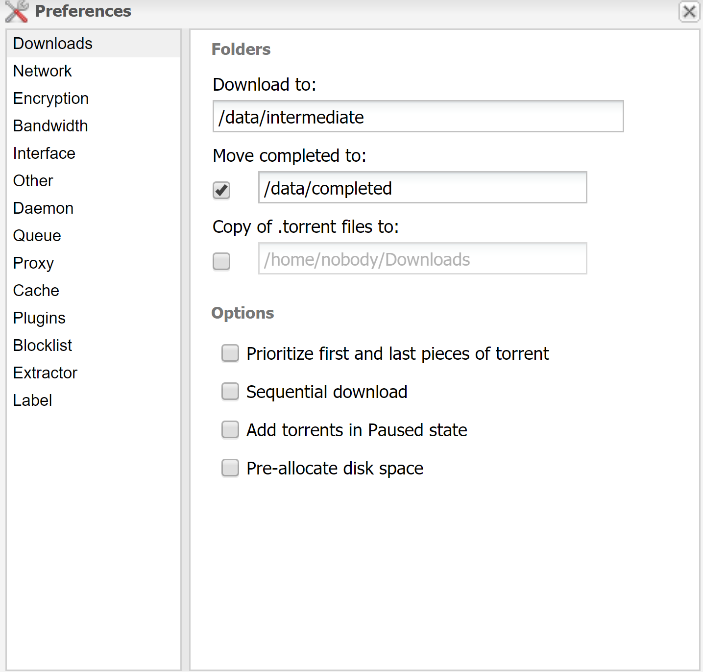

What do you have set for your completed download destination folder in Deluge settings and where are the completed downloads actually being saved?

What do you have set for your completed download destination folder in a Deluge settings and where are the completed downloads actually being saved?
Attached is the filepath I am using now. I believe it is going to the location I will confirm with a new download shortly. Once there it is not being moved by Sonnar into the final locations

Post your run command for Deluge and Sonarr and a screenshot of the error you get in Sonarr.
https://forums.unraid.net/topic/57181-docker-faq/
I am not sure what the run command is or how to get it. Here is the error code I see most often. Not sure if this is the one or not.

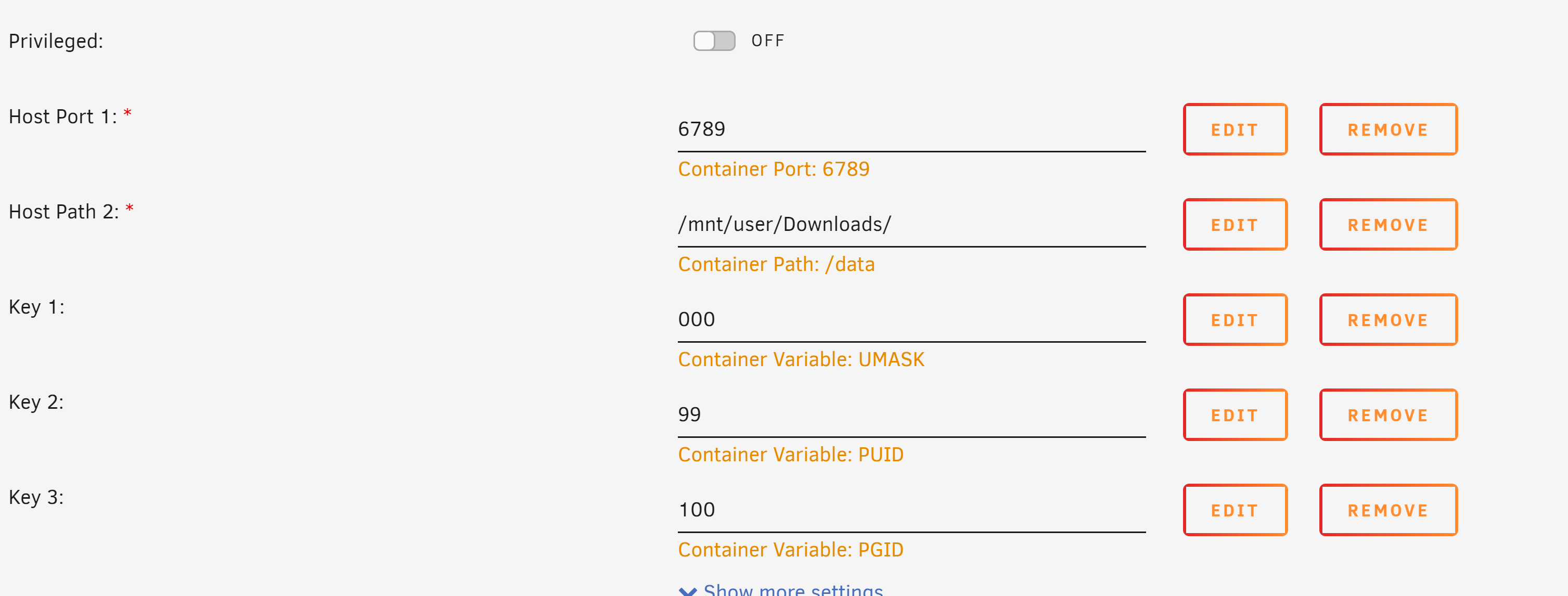

Deluge:
root@localhost:# /usr/local/emhttp/plugins/dynamix.docker.manager/scripts/docker run -d --name='binhex-delugevpn' --net='bridge' --log-opt max-size='50m' --log-opt max-file='1' --privileged=true -e TZ="America/Los_Angeles" -e HOST_OS="Unraid" -e 'VPN_ENABLED'='yes' -e 'VPN_USER'='p9426198' -e 'VPN_PASS'='Goodhome1' -e 'VPN_PROV'='pia' -e 'VPN_OPTIONS'='' -e 'STRICT_PORT_FORWARD'='yes' -e 'ENABLE_PRIVOXY'='yes' -e 'LAN_NETWORK'='192.168.1.0/24' -e 'NAME_SERVERS'='209.222.18.222,84.200.69.80,37.235.1.174,1.1.1.1,209.222.18.218,37.235.1.177,84.200.70.40,1.0.0.1' -e 'DELUGE_DAEMON_LOG_LEVEL'='info' -e 'DELUGE_WEB_LOG_LEVEL'='info' -e 'DEBUG'='false' -e 'UMASK'='000' -e 'PUID'='99' -e 'PGID'='100' -p '8112:8112/tcp' -p '58846:58846/tcp' -p '58946:58946/tcp' -p '58946:58946/udp' -p '8118:8118/tcp' -v '/mnt/user/Downloads/':'/data':'rw' -v '/mnt/user/appdata/binhex-delugevpn':'/config':'rw' 'binhex/arch-delugevpn'
7991b7e747119d8b9d25f7337d93cacedf3947cf46160619e05f0add0800ab62
Sonarr:
root@localhost:# /usr/local/emhttp/plugins/dynamix.docker.manager/scripts/docker run -d --name='binhex-sonarr' --net='bridge' --log-opt max-size='50m' --log-opt max-file='1' -e TZ="America/Los_Angeles" -e HOST_OS="Unraid" -e 'UMASK'='000' -e 'PUID'='99' -e 'PGID'='100' -p '8989:8989/tcp' -p '9897:9897/tcp' -v '/mnt/user/Downloads/':'/data':'rw' -v '/mnt/user/Media/TV Shows/':'/media':'rw' -v '/mnt/user/appdata/binhex-sonarr':'/config':'rw' 'binhex/arch-sonarr'
8e3f56ed775cac3033f9bd866d30c34895488bc7f30c14e2fdc21cca41115099
Your paths appear to be correct. What error does sonarr give you for failed imports? You can just hover your cursor over the yellow download icon next to the failed import in sonarr>activity>queue to see this and take a screenshot.
Also, just to be sure, when you test your connection to deluge in the sonarr settings does the test pass?

Deluge does indeed pass and will start the download. I just saved everything and did a download test and it worked perfectly. Very odd since I tried last night changed nothing and got different results. I do notice that the files remain in the download/completed folder but they do appear in my media folder as expected. Do users typically delete these folders manually or am I missing a setting to delete them off? It could be that the files are being seeded so they are stored on the cache disk until removed but I am only speculating. I appreciate the help you are awesome but I have to assume it works since the last download works as expected.
I use the auto remove plus plugin in Deluge to delete the files after they have seeded for a while. It is very customizable.
