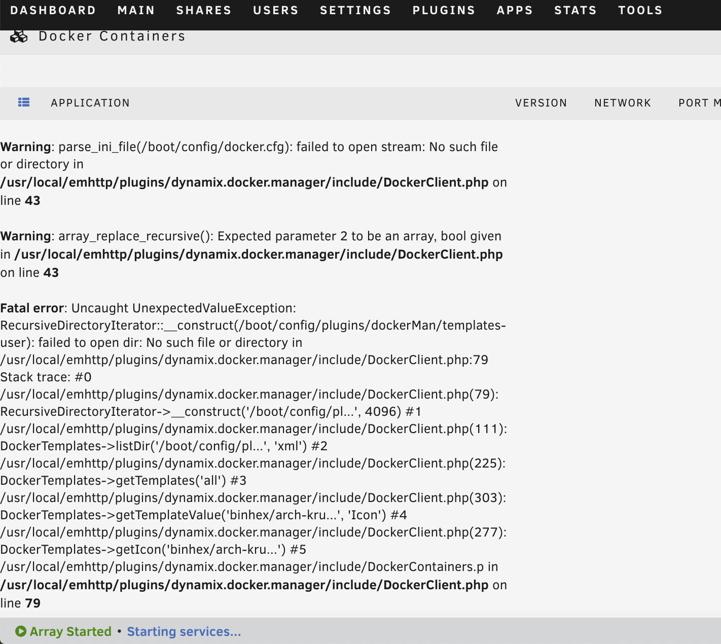

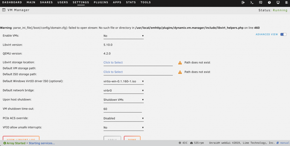

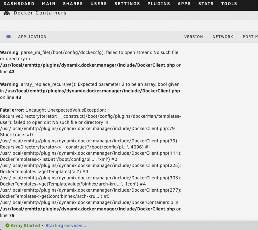

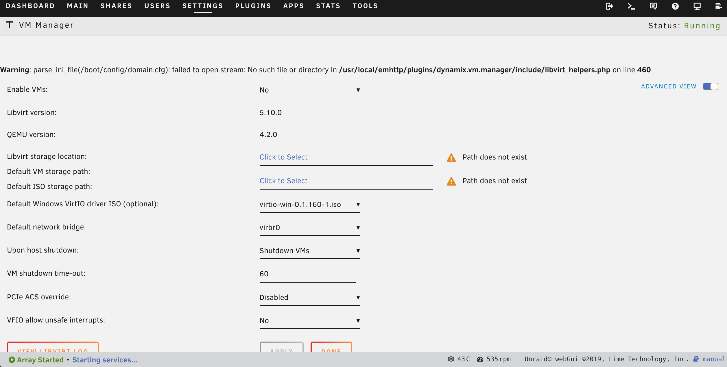

Errors started at 10:53 today (1/18/20) in the logs, when I was stopping Dockers.
In the Web GUI footer, it's repeatedly "Starting services...", and the Docker and VM tabs in the header are missing. Screenshots of the errors showing in the VM Manager and Docker pages are attached, along with diagnostics. The containers that were running when this started are still accessible and running, though.

It is a flash problem but not necessarily dying, first try re-doing it and make sure it's on a USB 2.0 port.
by "re-doing it" you mean removing the flash drive and running the USB Creator on it anew? It's definitely in 2.0, the MOBO doesn't have any 3.x
Backup the config folder, recreate flash with USB tool or manually, restore config folder.
