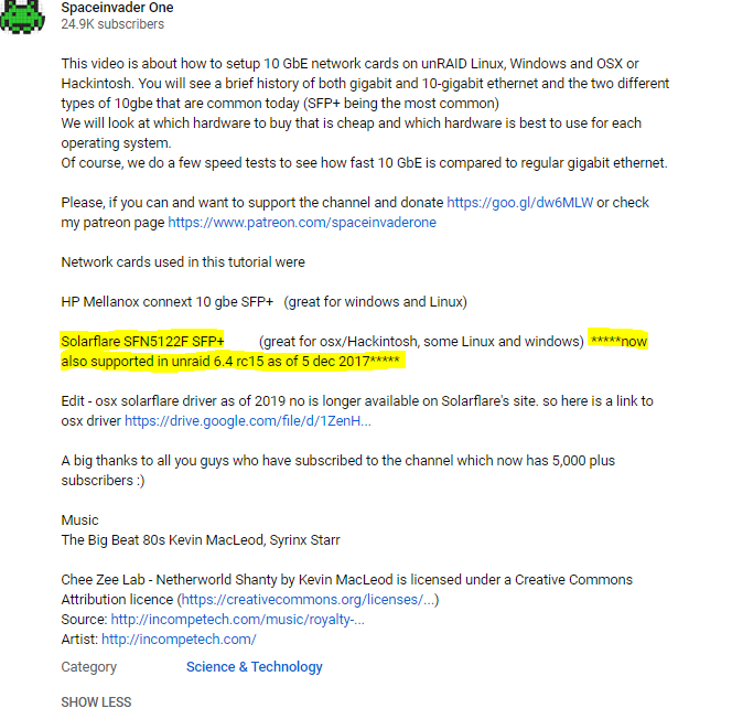

Did you check out the video by Spaceinvader one? If I understand him correctly, he explicitly states that the Solarflare card does not work with unraid, hence his use of Mellanox cards....
Oh yah, oh yah I did.
That video was exactly why I almost didn't bought it when it showed up cheap on ebay.
Then silly me opened the video's description.
If I understand him correctly, the same guy who explicitly states that the Solarflare card does not work with unraid actually went ahead and edited the description 7 days after to explicitly states that the Solarflare card does in fact work with unraid.
Am I supposed to trust SpaceInvaderOne Circa nov 2017, or SpaceInvaderOne Circa dec 2017 ?
Edited by Keexrean

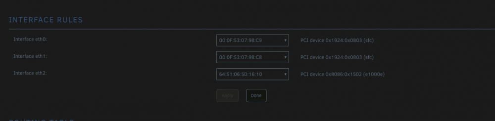

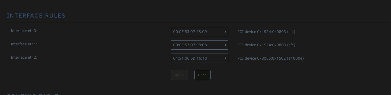

I run a SFN5122F in a z420 and actually split the ports: 1 for Unraid and 1 for a VM. so it works.
post a screenshot of the following section in the network settings:
1277792235_ScreenShot2020-01-19at1_27_35PM.thumb.png.c8250c4c1a28809d62230bcd2459af4f.png
Yes, that was me risking a kernel panic, dabian habits.
lsmod doesn't list sfc. It indeed isn't loaded, even though I did several >modprobe sfc
I'm using bog-standard unraid 6.8.1, andso far never did anything to the kernel or drivers, never had to on this box.
Edited by Keexrean
@1812 I simply don't have this view, since it only detects the single rj45 port of the motherboard, and nothing else.
make a copy of the config/network.cfg file from the flash drive to your desktop (as a backup), then delete the one on the flash drive and reboot the server. this will force new settings and maybe it will pickup the solar flare card. if not, I'll dig through your diags a bit more  looking at your logs, this prob won't help.
Edited by 1812

New bios, the SFN5122F was still in the top x16 slot, and still wasn't detected.
I moved the SFN5122F to the bottom x16 slot (as a test) and NOW it works! detected in network interfaces and all!
Now, drum rolls, it HAS to work in the top x8(x4) slot, or I'm one PCIe slot short. OOF
Update²: the SFN5122F refuses categorically to work in any of the top two slots.
I can take any graphics card I have at home and plug it into into the top x16, the x8(4) gen2 or even the x8(4) gen1 (not the 5700xt though) and it will pass through to a VM with no hassle.
And this SolitarBollocks piece of foo-foo of a card refuses to work in any other slot that the bottomx16 that I need for GPU passthrough...
