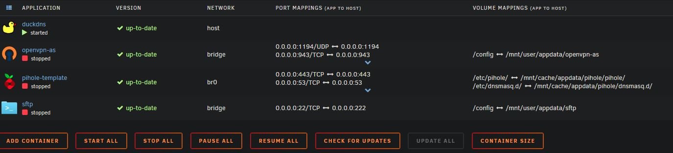

I'm trying to setup a second Unraid device and seem to be running into a problem with Docker. All my container port mappings have an IP of 0.0.0.0 and none of them work. What am I doing wrong?
Go to Tools - Diagnostics and attach the complete diagnostics zip file to your NEXT post.
Those apps aren't running.  Therefore no IP is assigned...
None of them will start. When installing the apps they all have an error that 0.0.0.0:whatever port is already in use.
Search (and a ton of features on the forum) is currently messed up, but if you hit the support thread for pi-hole (click on the icon and hit support), you'll probably see the answers to why that's happening.  I know there is a special trick for pi-hole
