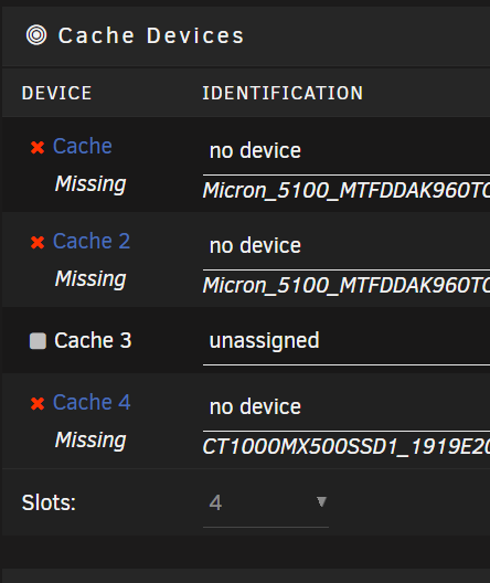

I finally get to this, I'm now at step 3: unassign all cache devices. Since there is no 'Unassign' button or drop down, I assume you meant choose 'No Device' next to each of the 4 cache slots. So I chose 'No Device' for the cache 1, 2, 4. As for Cache 3, there no other option other than choosing one of available drives, so I leave it as 'Unassigned'.
So right now, this is how it looks like:
Cache 1: Missing (x)
Cache 2: Missing (x)
Cache 3: Unassigned
Cache 4: Missing (x)
Now before I proceed to 'Start the array', are these states how they are supposed to look like? Just want to make sure :)
Yes
