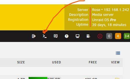

Let's try this:  On the server, open up a terminal window by clicking here:
Then type the Following command:
ls -al /mnt/user0
Capture a screen shot and post it up.
