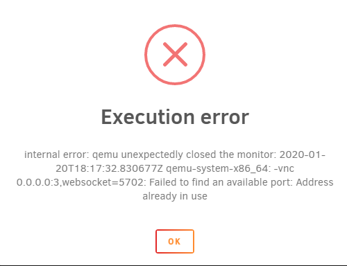

I have 3 VMs running, the 4th wont start with this error.  Other VMs start and stop normally.  Not sure what to look at to correct this.  Any ideas?

Well, the nginx error is gone but the VM still wont start.  Now the error is:
internal error: Failed to reserve port 5702
Did you set a port in your xml file? If so check it does not conflict.
bingo, i had to edit the xml instead of using the form view.
The port was set to -1, I assume that means auto but I changed the websocket to 5703 and then it started.  Thanks.
