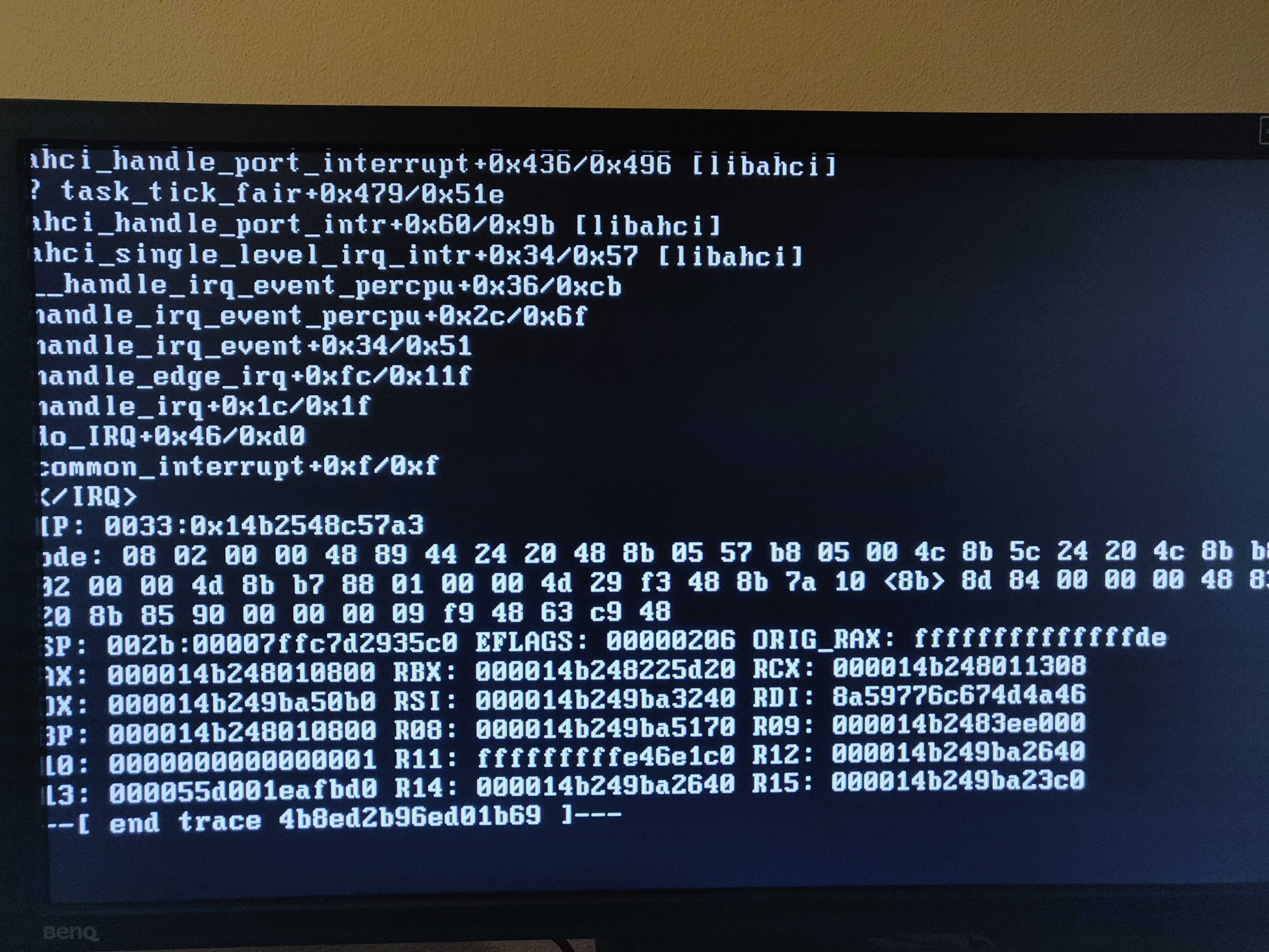

So far, I've had my unraid server crashing 2 times.
Basically, the server becomes unusable, docker images wont open, can't even access the unraid panel.
The first time was when I was moving 400gb of my old files to a shared folder.
The server just stop responding, and then I had to manually shutdown the computer.
In here I could see some errors about the CPU I think, maybe it was a bit overloaded.
The second time, I went to sleep and left some files copying to my Nextcloud docker.
Unfortutally I forgot I has the Nextcloud folder in my cache disk and it got full with only 5gb left or something.
When I woke up, all my services were gone and couldn't again access the server, nor unraid admin panel.
Again, I had to shut it down.
Is there any good practices to avoid this, is this an error? Can someone please guide me or give me some details? :)

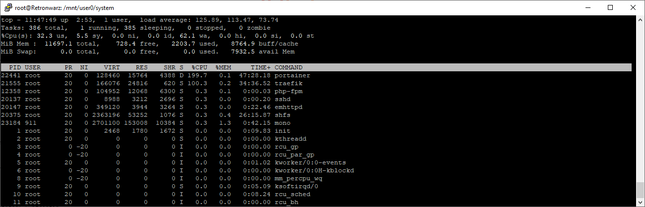

The server just crashed now while I was sending some 30gb to nextcloud.
It seems I have my CPU running @ 100%
I then SSH to the server, ran `top` and this is what I get:
In my unraid backend I can move by some menus, but I can't do anything.
The Diagnostics doesn't create any file, the docker menu doesn't get fetch any results...
This time I have 150GB free on my cache :)
Note: I have docker-compose and my containers are created from the docker-compose that I add as attach
