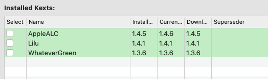

I've installed Kexts Lilu, Whatevergreen and AppleACL. All latest and loaded by system.
1650885478_Screenshot2020-01-21at20_06_40.png.51554bc6556fb5341a56695745d66a2e.png1755466668_Screenshot2020-01-21at20_06_29.png.0d07f5697b9f793689a6b2b3bc3031e6.png1076676066_Screenshot2020-01-21at20_06_14.png.df2c0cc3c60750e3dee923a9393adfc9.png

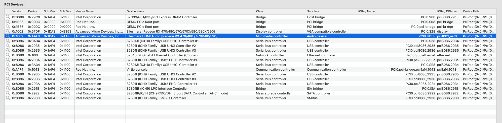

I see device in PCI devices!
923929855_Screenshot2020-01-21at20_10_01.thumb.png.9593b5a85897dc60379f2952abdc4ab7.png

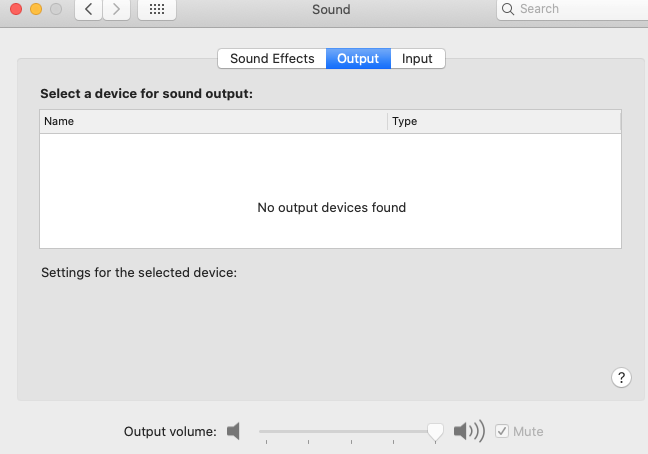

But I see nothing in MacOs settings audio :(
