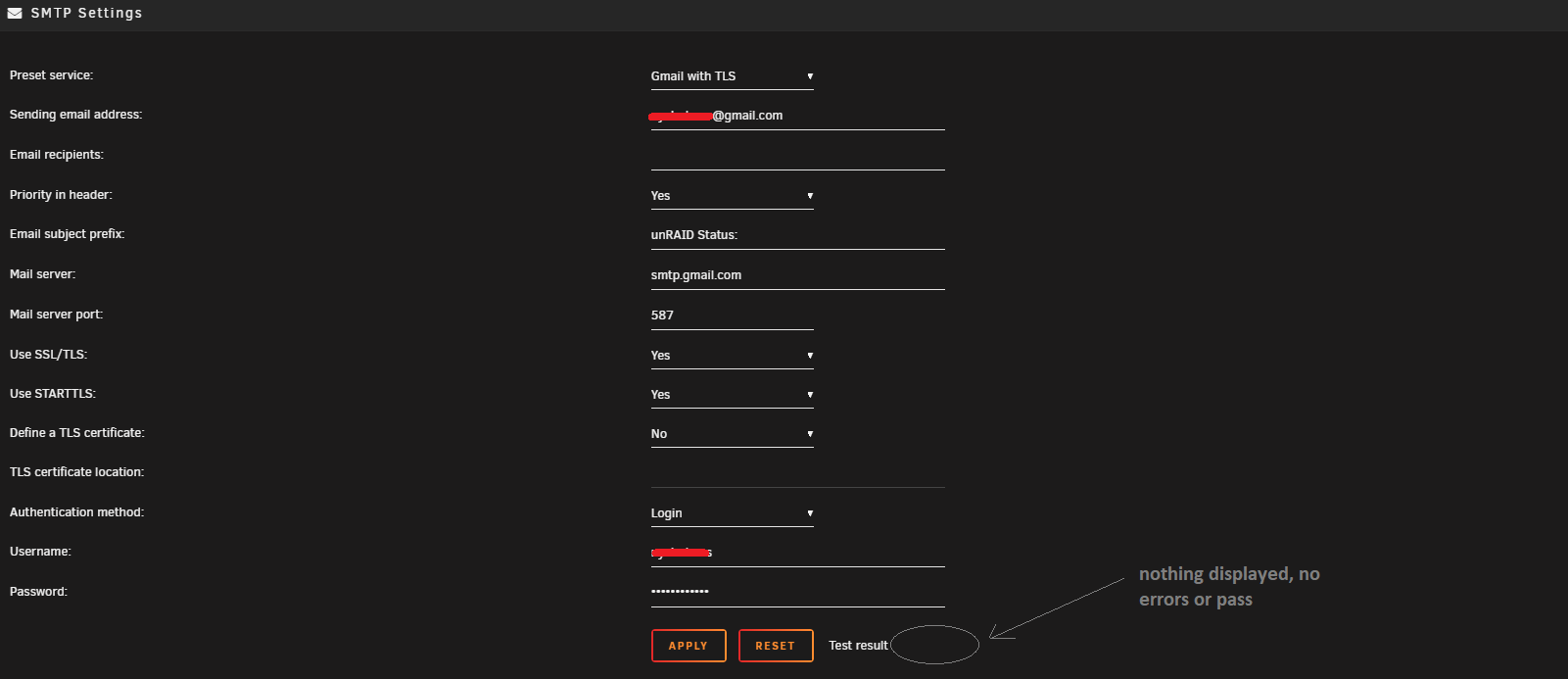

Here is my Screen shot of the SMTP Form:
Checked email system including spam, tried incorporating other recipients and testing different other servers (example - Live/outlook)
Nothing! -

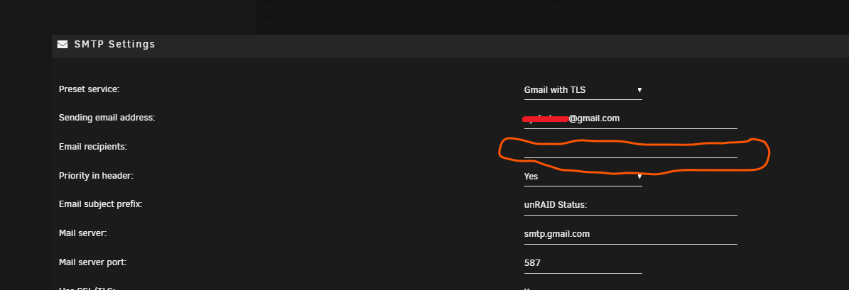

You don't have an E-mail recipient listed in the SMTP Settings.
image.thumb.png.9ddcdc0681f858a7daa6c53a3a0c9c5d.pngimage.thumb.png.010ee8c69b0913389b56c31d32c6b810.png
One more thing.  Don't send mail to yourself--  Same recipient as sender.   It could get tagged as Spam.

What is surprising is that it was failing quietly in the syslog listing.  I would think that sSMTP should provide an error message when there is no recipient for an e-mail...
I was just thinking this, some sort of message - "you missed out the recipient"
Instead of being blank or failed (Fail usually gives bad credentials within sys log) would be good if that was projected into the GUI
