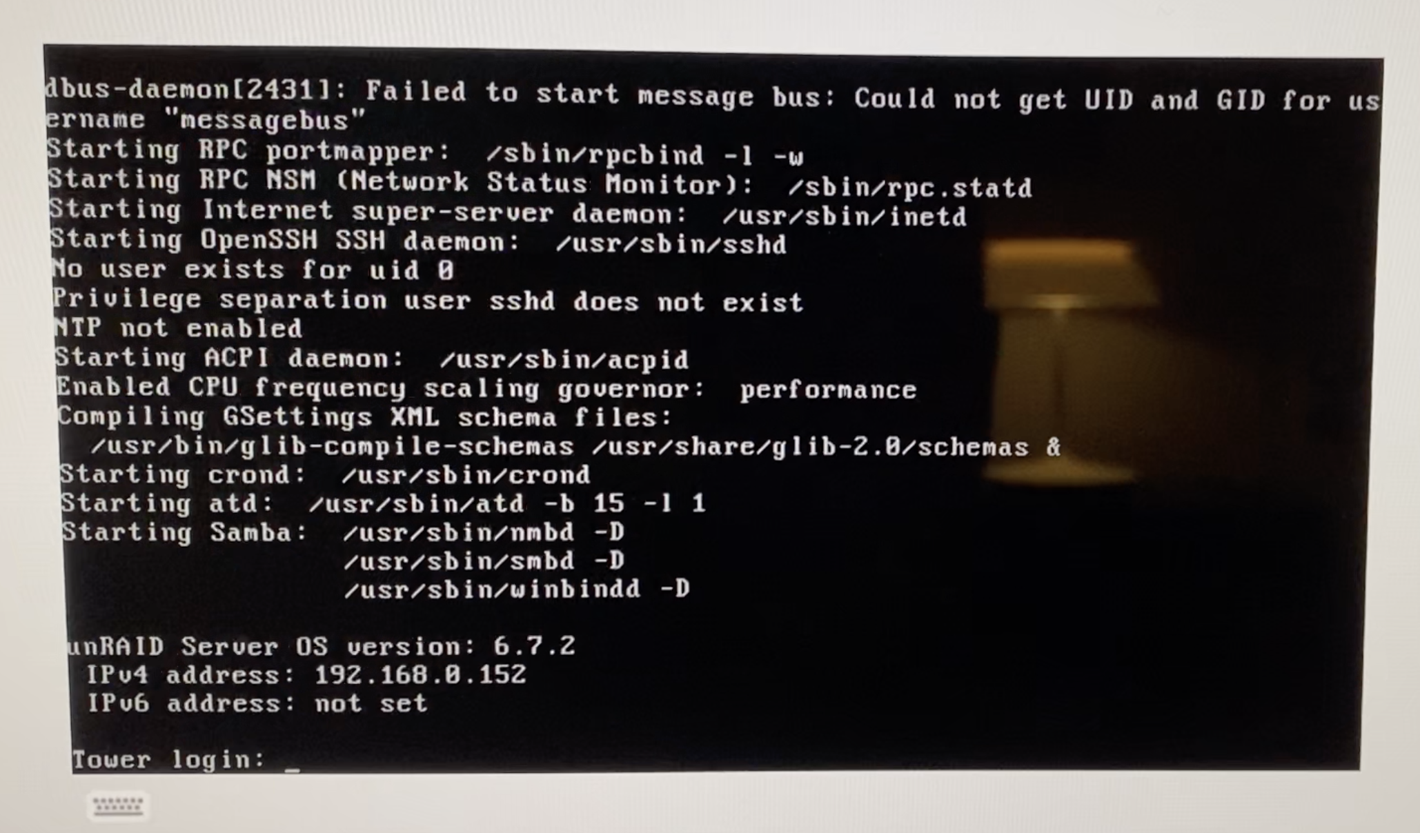

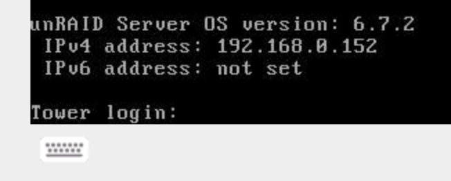

And UnRaid itself at console says that's it's ip as you can see on attached screenshot

Here is what console says just after a reboot, things that I think looks strange.
No user exists for UID 0
Privilege seperation user sshd does not exist
Failed to start message bus Could not get UID and GID for user messagebus
Also I renamed this UnRaid server to be named "UnRaid", but at console it says Tower, not 100% sure if it always does that or if it shows your actual server name there.

Thats weird. Also it does normally show your server name there if you renamed it from tower.
18 minutes ago, BTR2255 said:
it says Tower,
That'll only happen if you flash drive has dropped offline which will explain a ton of problems.  Try another port, preferably USB2
