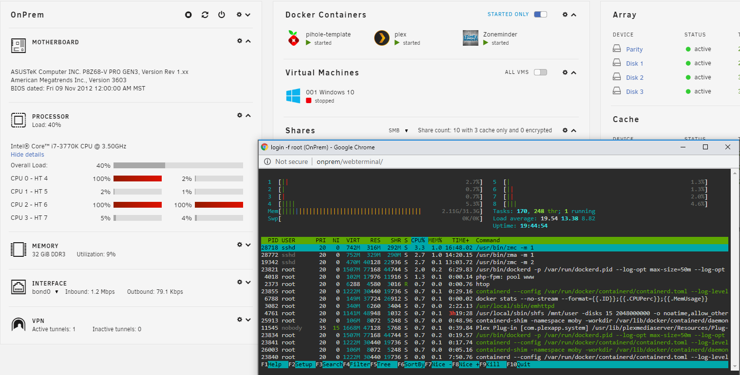

My "onprem" unraid server is acting strangely.  Seems every day or two the webgui will start showing strange data and fail to update fields.
  • Strange data: shows 3 of 8 threads pegged at 100%, while htop shows no activity.
  • Fail to load: unattached devices section of Main, docker, shares - all missing data or don't load at all.
If I click around the webgui a few times it generally crashes the gui completely and the webpage won't load anymore ("internal server error", or "Gateway Time-out").  Meanwhile SSH works and SMB shares still respond as normal, except for "diagnostics" or any of the shutdown/restart commands.  Server broadcasts that it is collecting diagnostic data, or shutting down, but nothing actually happens: image.png.2306e50a0ab231075bca8445a1e67492.png

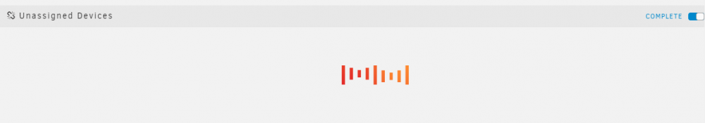

-webgui showing several CPUs maxed, but htop is showing idle.
-Unassigned Devices won't load.  (should be a 2.5" USB harddrive here)
These are the initial display errors.  Eventually the page will not load at all anymore.
Yup, worked for 2 days with the VM running.  All I did was stop the VM, then 8hrs later I find the unraid server effectively crashed.
Nonsense CPU load reporting.  WebGUI eventually stops responding.  SSH connects, most commands seem to work but will not shutdown/restart.
