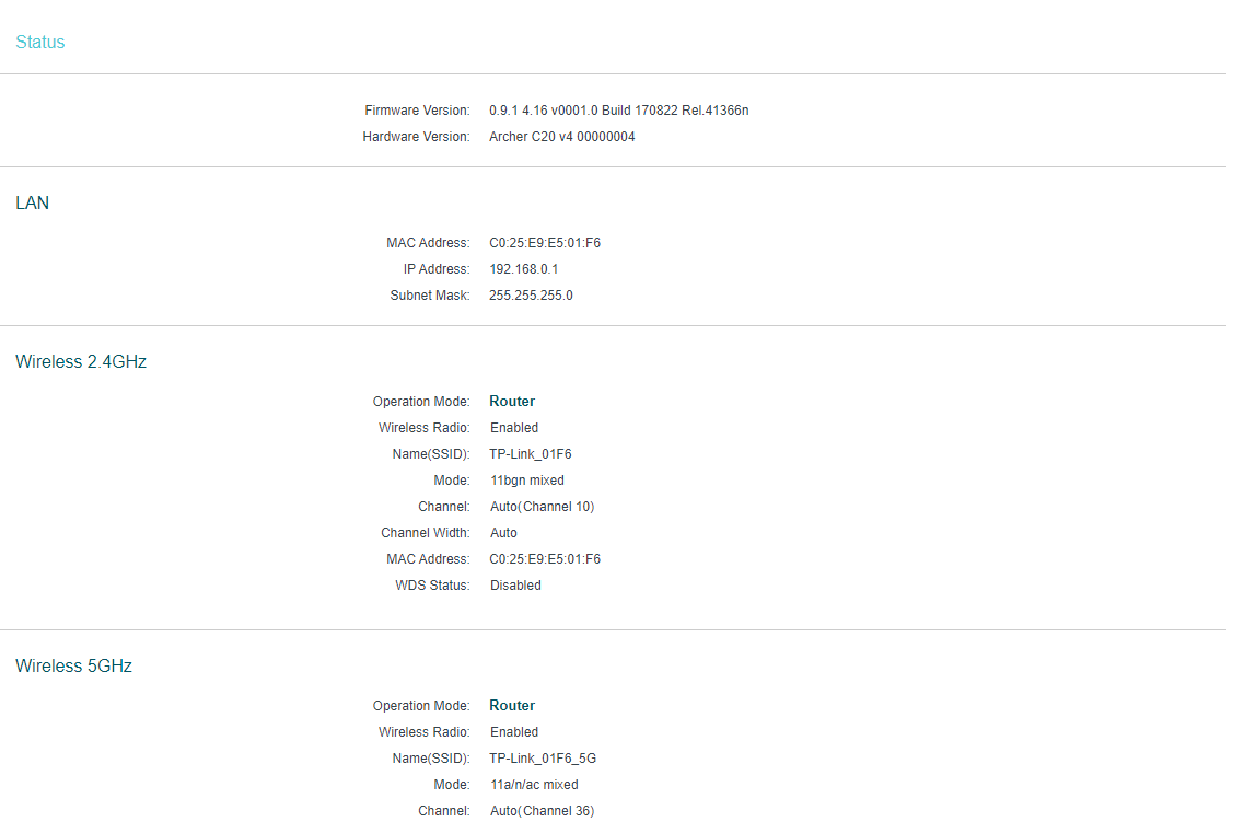

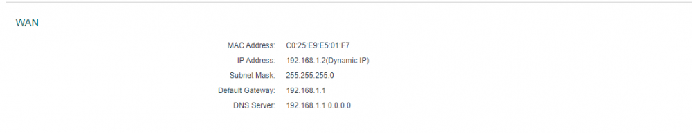

I just noticed that my unraid is not connecting to the internet. Not sure what screwed up but may be the router got reset itself is what i have observed so far.
Is there a proper way to check why this is not working and where to correct it. Adding the diagnostics data and the router status as well hope that helps.

Oh thanks man. Just got to know there were some ip gateway clash between the router and my network switch both being under the same name. Changed it, now working.
Another common thing, is the router DNS server safe ? I have set it as 8.8.8.8 and 8.8.4.4 under dhcp ip but in the above screenshot it still shows local ip!! is it fine?
