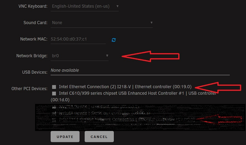

If the NICs are in their own IOMMU groups you should be able to pass one but not the other.
Funnily enough..... I've just tried.... And they are in their own IOMMU groups ..... and they both stubbed "successfully"
I say "successfully" because whilst they showed up in the VM edit and I was able to tick the boxes, pfsense couldn't detect both.... just em0.....
em0 did show as "Link Up" when I connected either the WAN cable or the LAN cable, but I can't get pfsense to recognise both NICs.
Sooooo.......... still baffled!

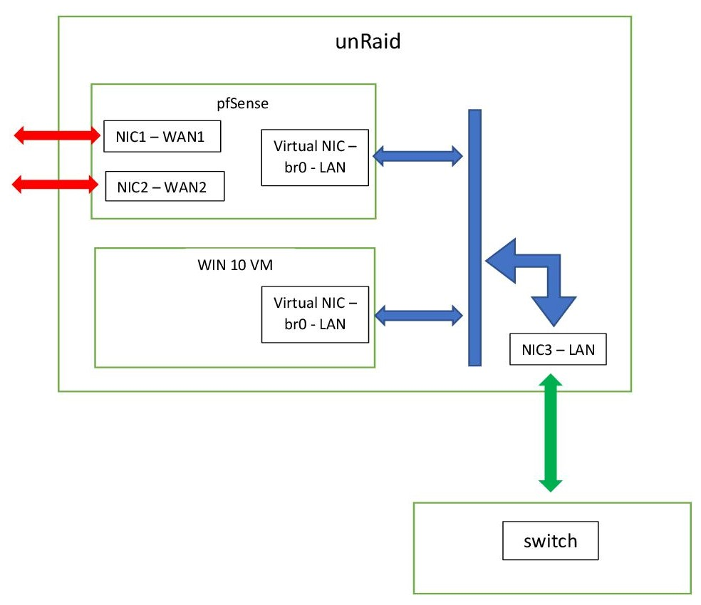

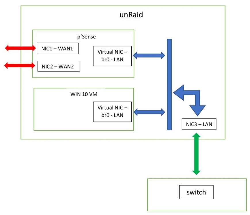

Hi my configuration is similar.
I've been using pfSense for about a year as a virtual machine on unRaid as my main router.
Because I have two internet providers, in my case I have three network cards in total, two built-in the motherboard and one additional (external).
In addition, unRaid also creates a virtual network card that is available to virtual machines and gives them access to the LAN (in my case it's called "br0")
In my case an additional external card is used by unRaid as the main network card for LAN.

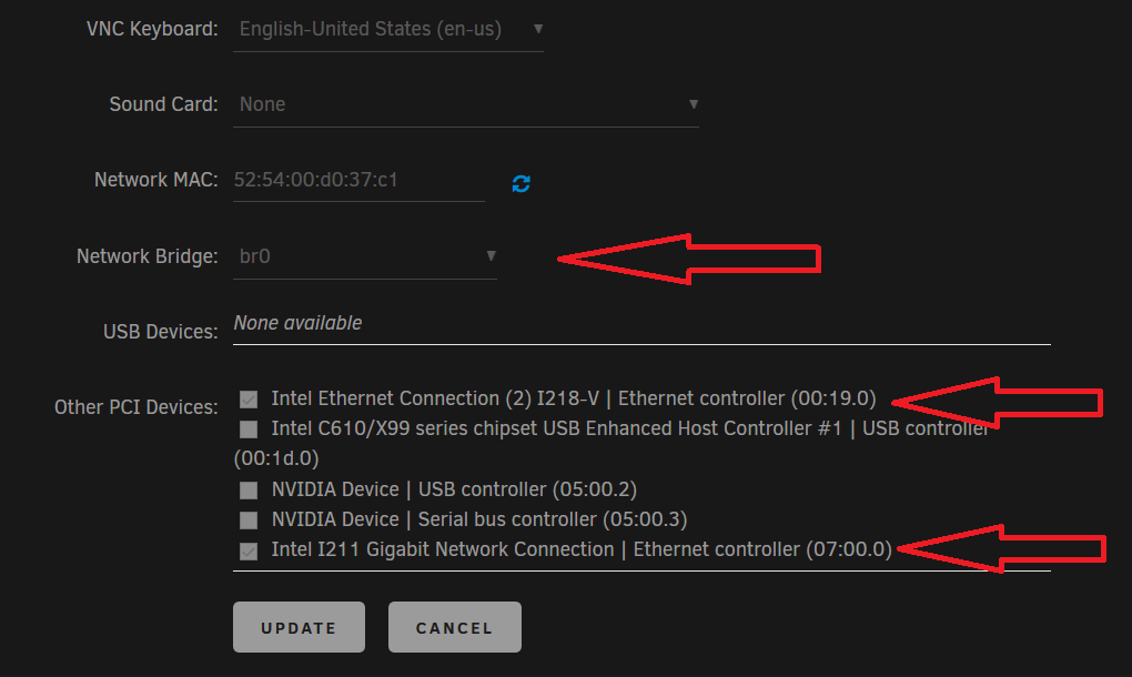

Two cards from the motherboard are forwarded to pfSense and are used as WAN ports (in unRaid OS configuration they are blocked and "not available" for unRaid). For everything to work well in the pfSense configuration, this internal link br0 is also available as LAN.
I hope you can see this on the image above.
And this is how it looks in my case.
I hope I helped a little.
Regards Janusz

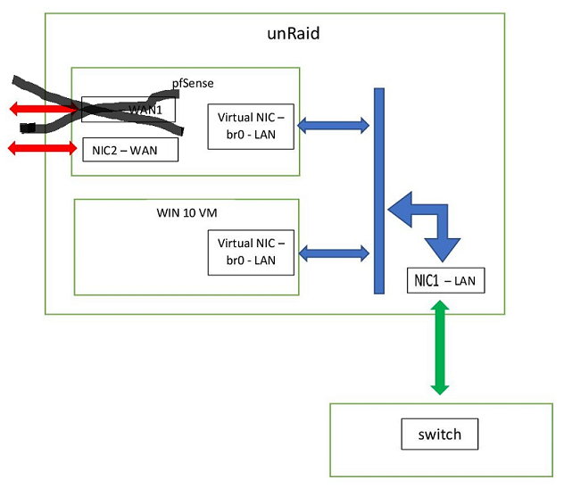

Hi
If you only need one WAN port, you only need two network adapters.
One NIC1 you use for unRaid LAN and the other NIC2 you use for pfSense WAN.
Just remember to select the virtual network adapter br0 for internal LAN in the main pfSense configuration.
Regards Janusz
