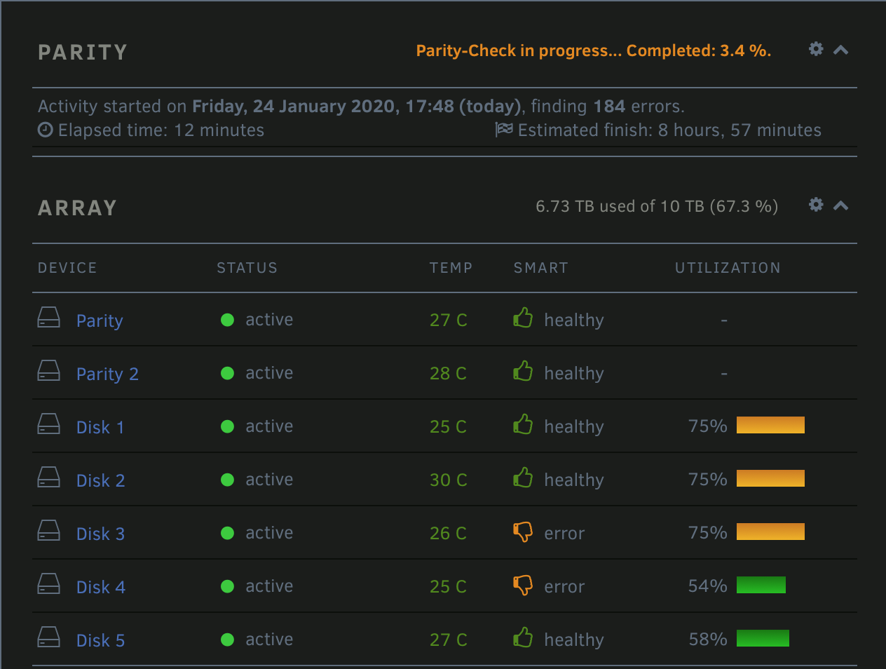

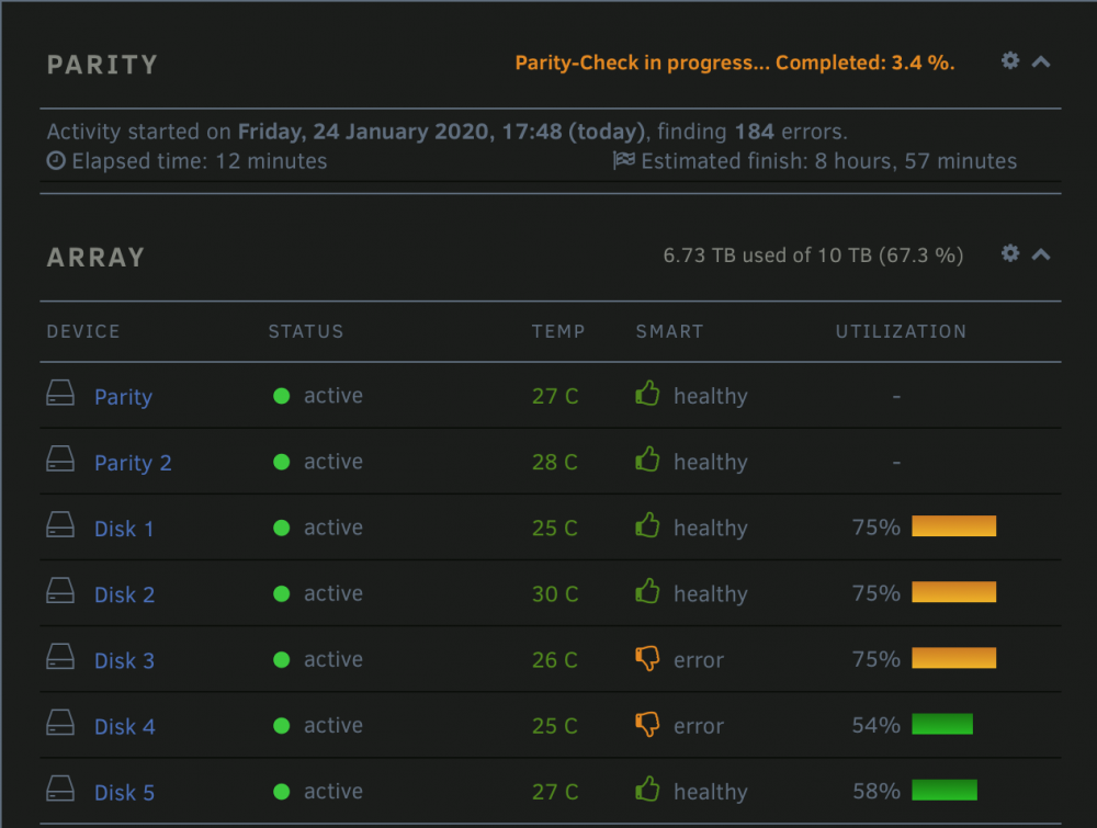

I recently had to replace x2 drives as they failed. I have dual parity drives and the data rebuilt no problem.
There was a period a couple of days ago when the Ethernet switch my Unraid server is connected to stopped working (have since replaced it) - the server did not have network access for about 12 hours - don't know if that could be related... Now I'm noticing that both drives I replaced are throwing UDMA CRC errors, every time Parity check fails and it crashes the error count goes up (see screenshot). Both drives were pre-cleared without issue and had been working fine up until now.
3 disks (including disks 3 and 4) are connected using a SATA port multiplier (can't say if it's embedded on the Asmedia controller or external), those are not recommended and can cause several issues, first thing would be to try without it.

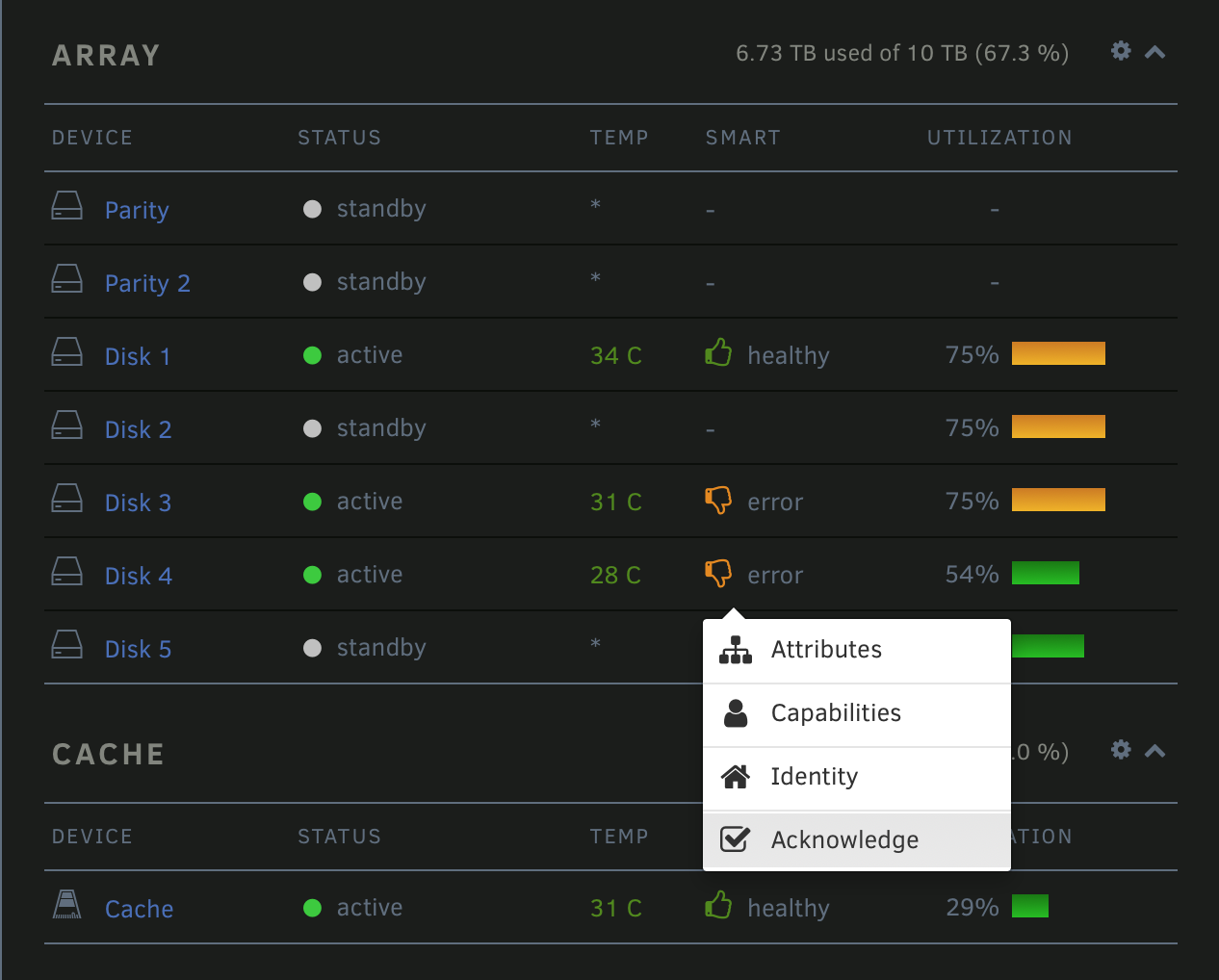

Parity check completed successfully! So i guess that you were right - it must have been the SATA card, Thank you. I've attached the logs - hopefully all good now?
Am I fine to acknowledge the UDMA CRC errors on Drives 3 and 4?
Thanks again for you help, much appreciated 👍
syslog-192.168.232.133.log
Yep.
