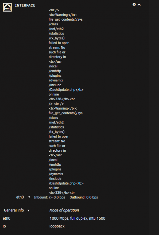

I recently removed a dual NIC PCIe card and since then unraid will bootup ok, but it can take 10 minutes before the web interface is accessible.
Within this 10 minute period I can ping unraid IP from other machines. I can ssh in and see that the shares are mounted. But cannot access web interface via IP or url, or any other dockers via http, or access shares via SMB.

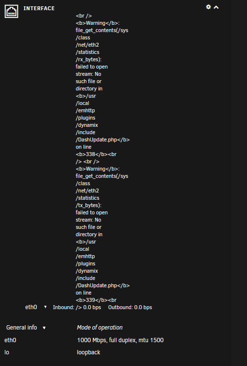

When I can finally access it, there is some weird text shown in the dashboard interface section. screenshot attached.
The 'route' command can take up to 30 seconds to display the results. Something strange is going on with the network, really appreciate any help . . .thank you
tower-diagnostics-20200123-1636.zip
Delete the files "network.cfg" and "network-rules.cfg" from the /config folder on your USB device.
This lets Unraid start with a default network configuration. Next go to settings -> network settings and adjust settings to your needs.
