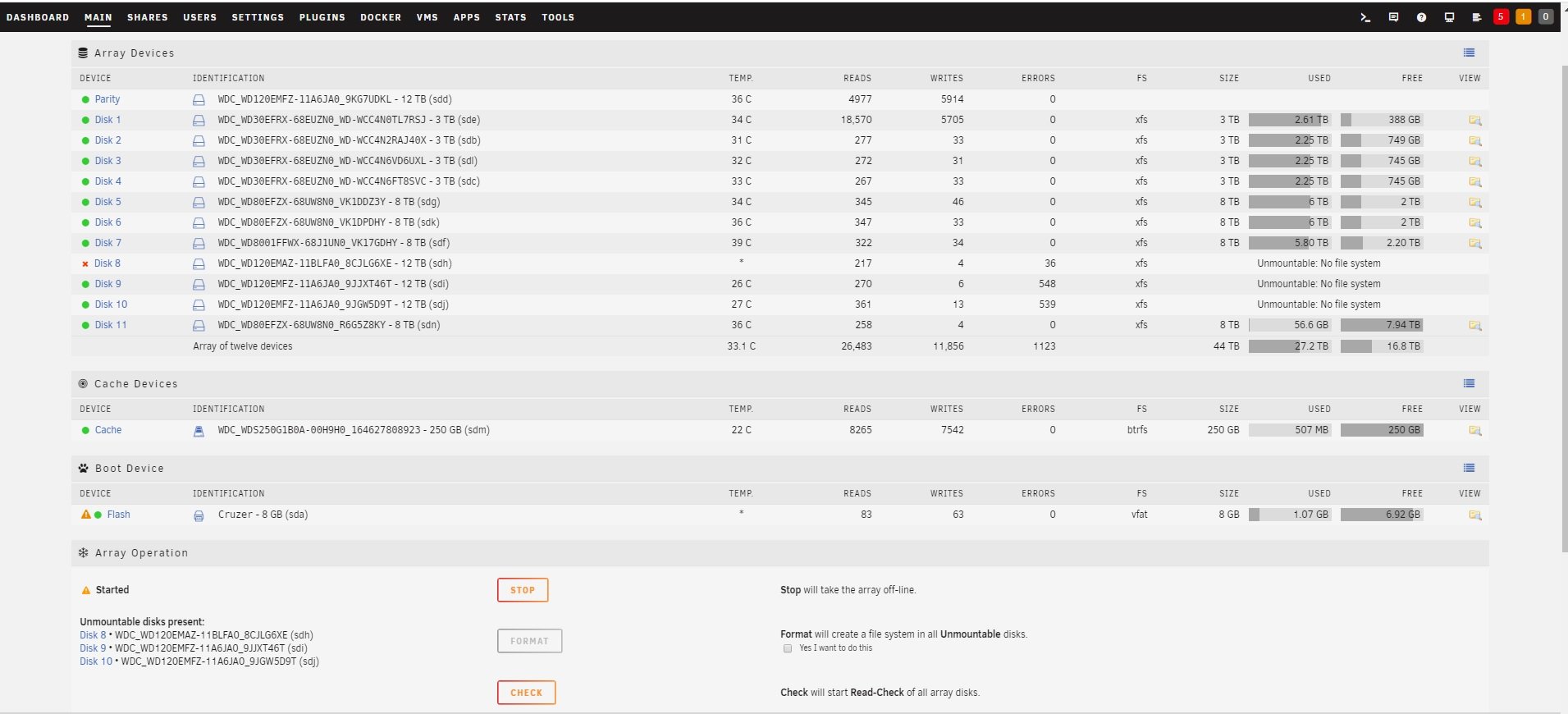

My server was working fine about a week ago and I did a clean shut down. It was down for about a week. Turned it on yesterday and 3 of the drives are listed as unmountable. And disk 8 has an error state. They are all new drives, that were formatted. When I got to the drive's page it does list xfs as the file system. I have been reading the boards and saw some of the suggestions of attempting to repair the mbr? Do I type the commands into the terminal thing on the web site or do I need to plug a keyboard directly into the server and type it in there. There is not important data on drives 9 and 10, but I do have data on drive 8.
Any advice is greatly appreciated.

I'm not an expert but from what I can see, all the unmountable drives are connected to the SAS card, all the mounted drives are connected to the internal motherboard ports.
Disks 8,9 and 10 all threw errors during initialisation but have clean smart data.
The SAS card seems to have repeatedly trying to connect to the 3 drives.
I'd check the seating of the SAS card and cabling and that any external expander / JBOD case has clean power.
Your disks are likely fine, probably connection issues.

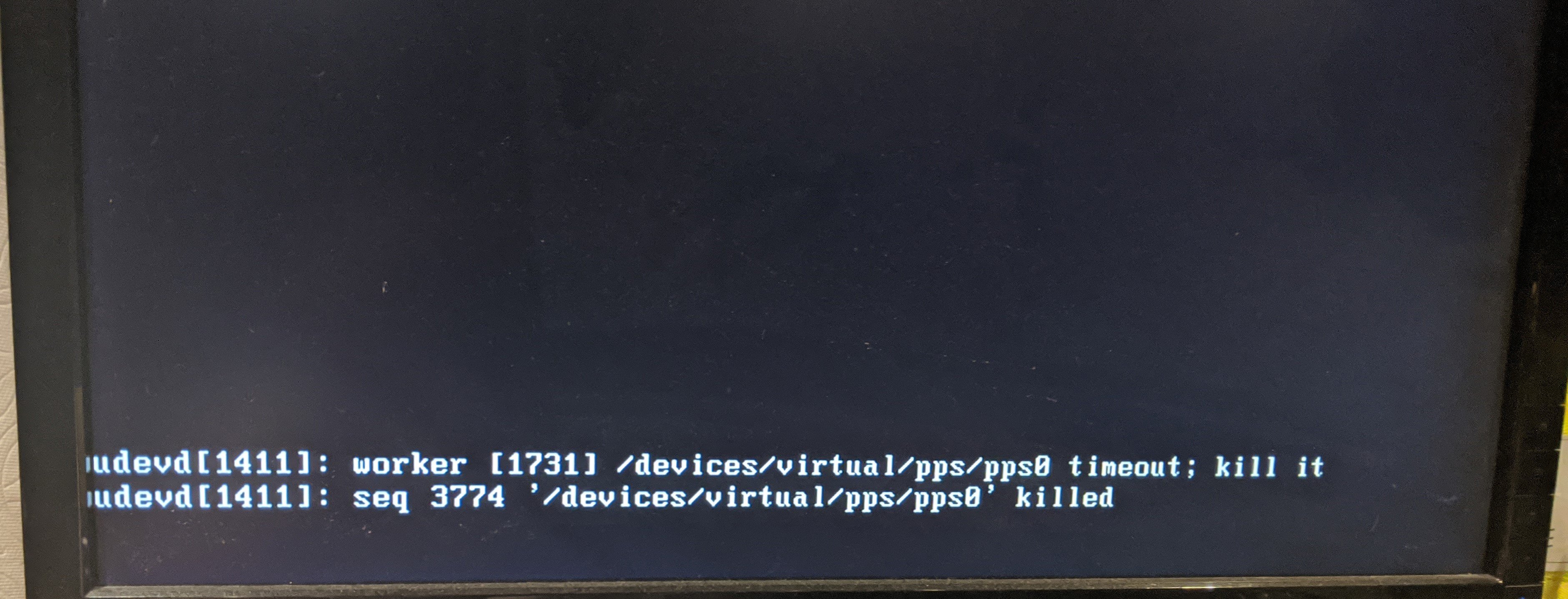

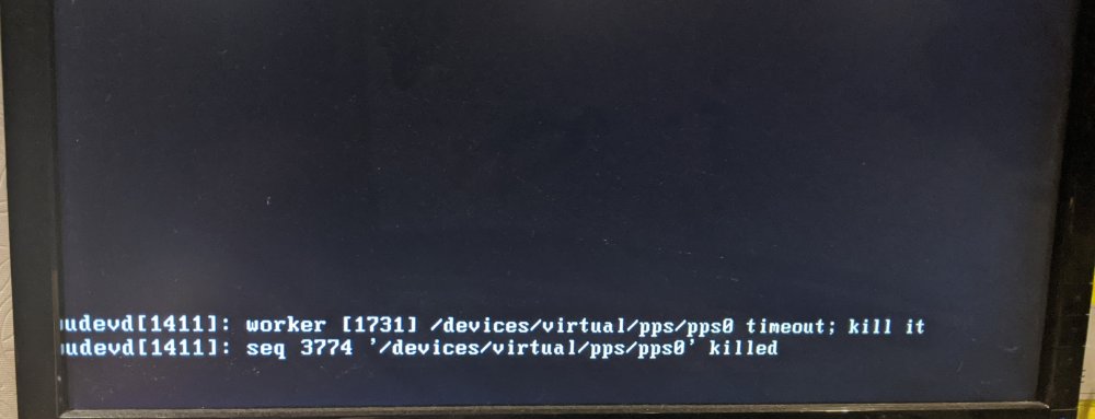

Got it working I think. I pulled the card out and reseated it. Restarted the system, got the following error message and it just hung for like 10 minutes. Google told me it might be a power/connector issue so I forced a shut and unconnected an reconnected the power to the drives. Booted up the second time, however drive 8 was listed as missing.

The crash on boot is likely this issue, you just need to try again, reportedly power cycling increases the chances of success, instead of a warm reboot.
As for the HBA, no errors so far, so everything looks good for now.

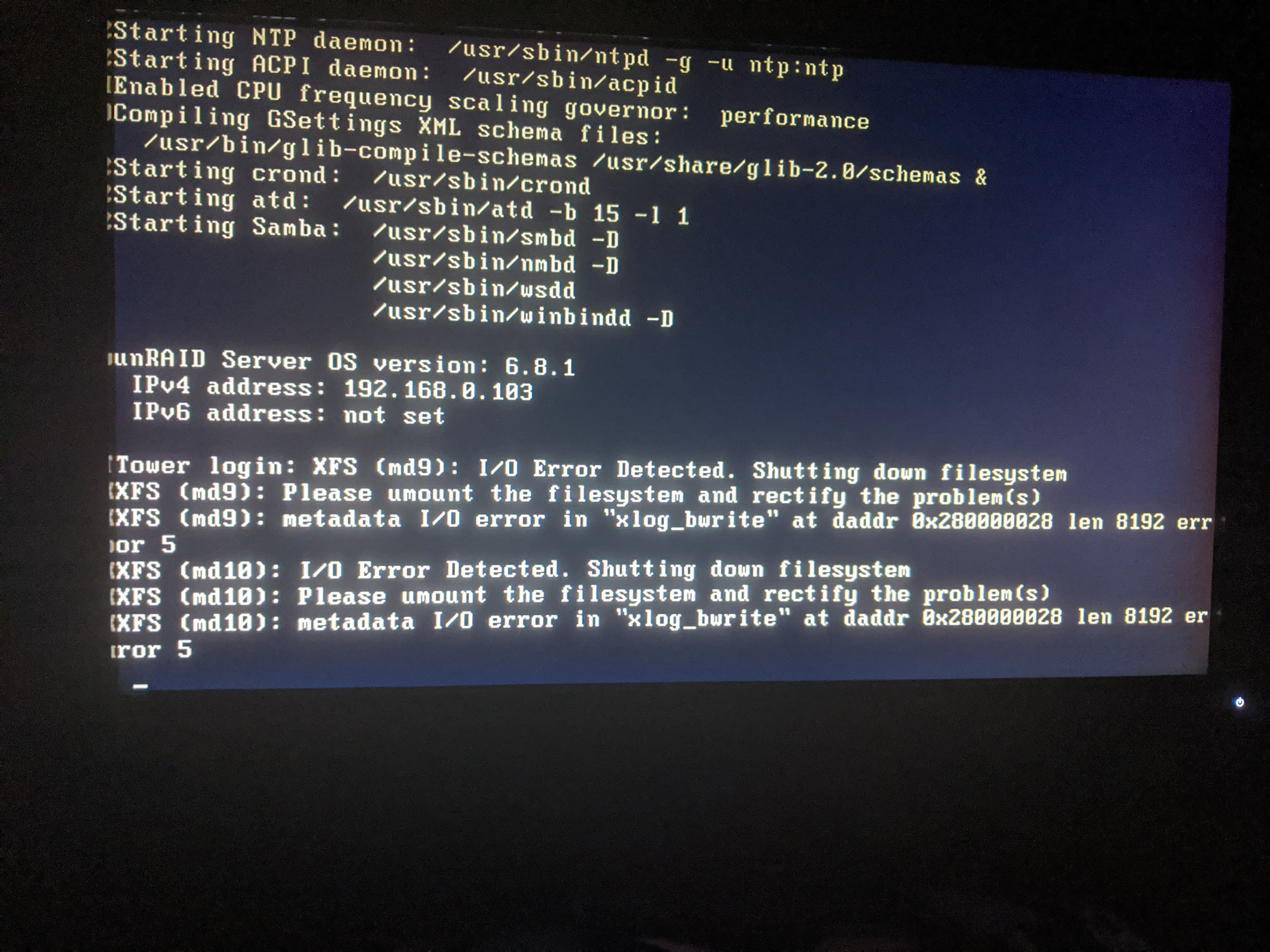

When you say power cycling you mean a forced shutdown? I.e hold down the power button? Any advice to keep this from happening it seems every time I turn off an restart the server this happens. The server boot up fine but then it throws this error.

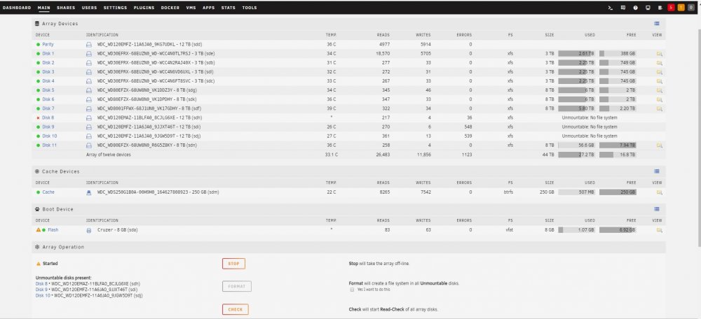

I think it is related (but if it isn't and I need to make a new topic I can). Since on the online interface at the IP address it show disk 8 unmountable (emulated) and 9 and 10 unmountable no file system.
If it was because of the the Intel NIC issue it was fixed on v6.8.2, update, but your problem seems different, LSI HBA is constantly faulting and resetting:
Feb  3 14:20:08 Tower kernel: mpt2sas_cm0: fault_state(0x2622)!
Feb  3 14:20:08 Tower kernel: mpt2sas_cm0: sending diag reset !!
Feb  3 14:20:09 Tower kernel: mpt2sas_cm0: diag reset: SUCCESS
This keeps repeating on the syslog, check HBA is well seated and/or try a different slot if available, you'll then need to check file system on the affected disks, but only after fixing the HBA issue.

Could this be because of a bad card? So I moved it to a new slot and it seems to have helped. The two drives (9 and 10) now show up normally. However the disk 8 is still disabled.
How do I go about checking my file system before fixing the drive 8?
That's expected, once a disk is disabled it needs to be rebuilt.
Disk8 is mounting correctly, so no need to fix filesystem for now, just rebuild on top.
