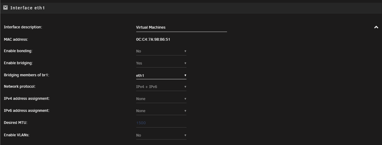

You need to configure eth1 (br1) with NO ip address (none). This will make the interface available to VMs without interfering with the routing of Unraid itself.

eth1's IP is set to 0.0.0.0, gateway=""
This isn't right. eth1 should be set to 'None', like this (in your case it can be IPv4 only)

Ok thanks dont know how I missed that.
eth1 = None in network settings now.
