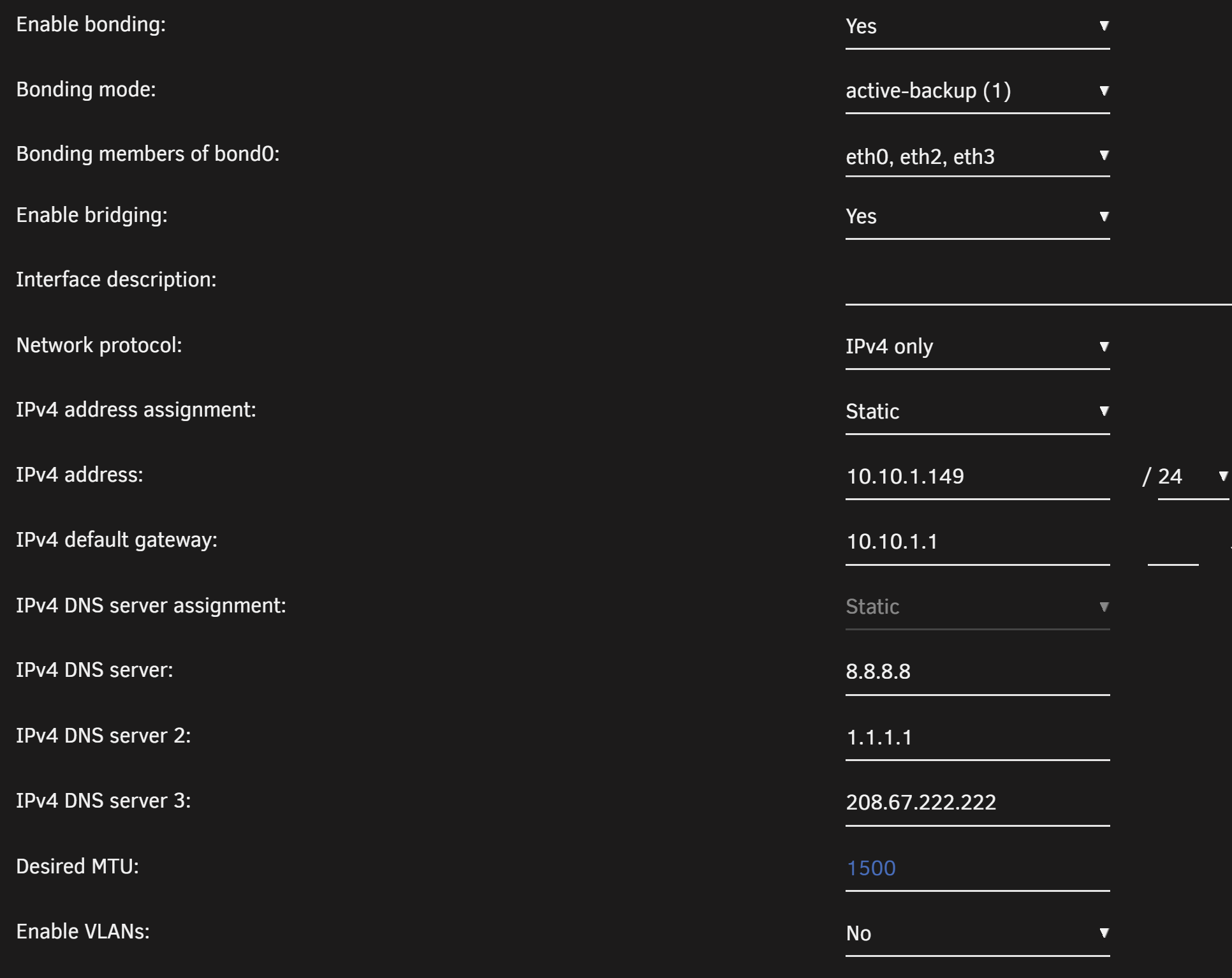

Not sure why, but Community Applications can't connect and it's telling me I need to "set static DNS addresses (Settings - Network Settings) of 208.67.222.222 and 208.67.220.220" and try again.
I know what DNS servers are and all that, but that's pretty vague.  Can anyone shed a little more light on what that means?

I noticed that, when I go to the terminal and try to ping out, I get no responses.  How can unRAID not have any network access but the VMs do?  Am I missing something?
  • rmp5s changed the title to Community Applications Can't Connect
Not sure what exactly "bonding" does in unRAID, let alone "active backup"...
