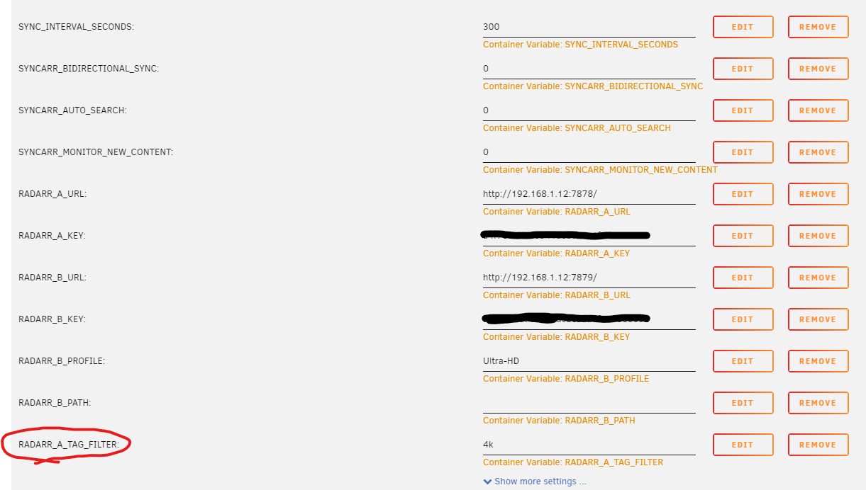

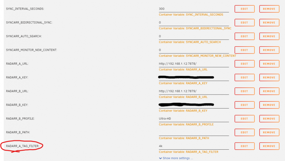

Syncarr: Forgive me if this has already been asked, but am I properly adding this variable to the docker container settings? I'm trying to only sync content with the tag "4k" from Radarr A to Radarr B. This variable wasn't in the default settings, so I added it based on the github page. Is this correct? I already had the docker running when this was added. After deleting all of the missing items from Radarr B, they got added again when the next sync occured, even with this variable set.
