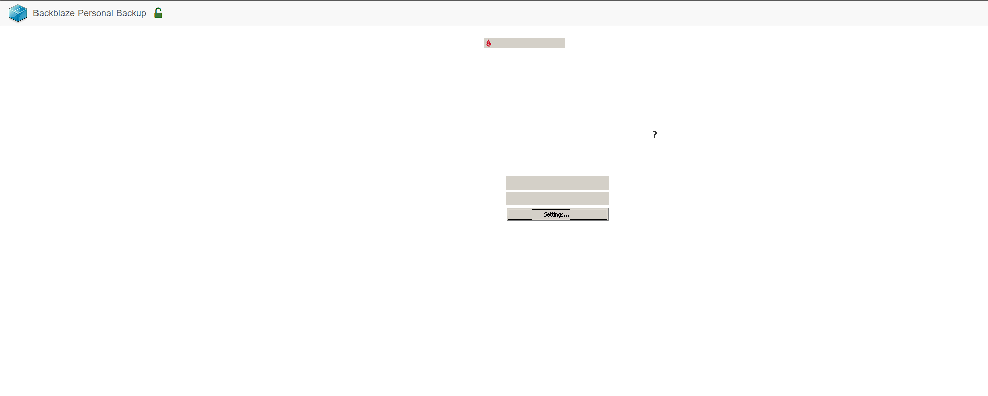

Has anyone had this issue? I was backing up my server using Backblaze, and ran into a pop up that said something about not having permissions to a certian backblaze file, and when I clicked on the message to read it, I get this screen. I have tried to rebuild the docker container 2 different times, and this happens.
This is after file discovery, and when stuff starts trying to back up. I click onto settings, and this happens. No matter how many times I stop the container, or restart it nothing changes from this point forward. image.thumb.png.14a82025496fdd43247fda919b2e22b2.png

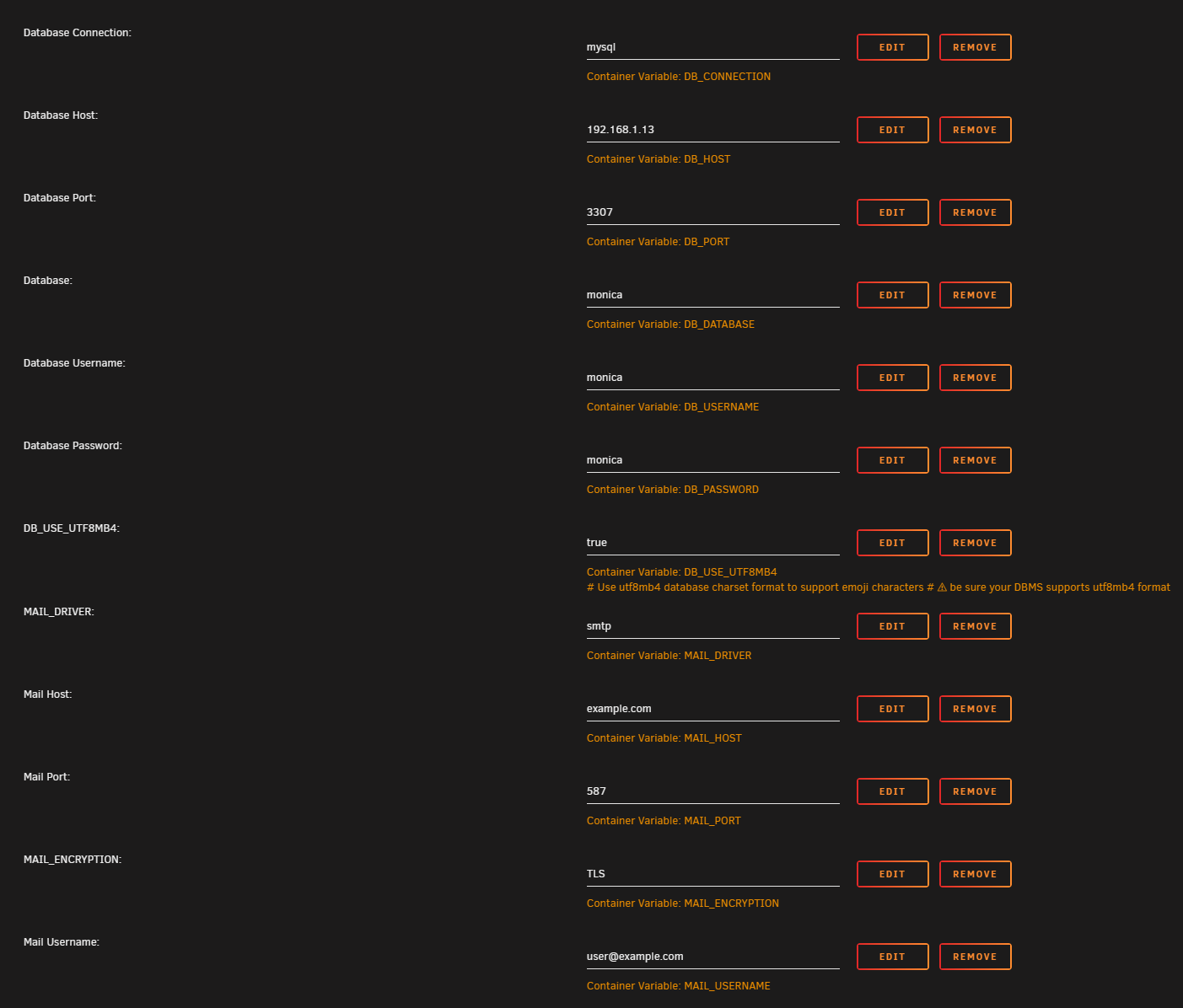

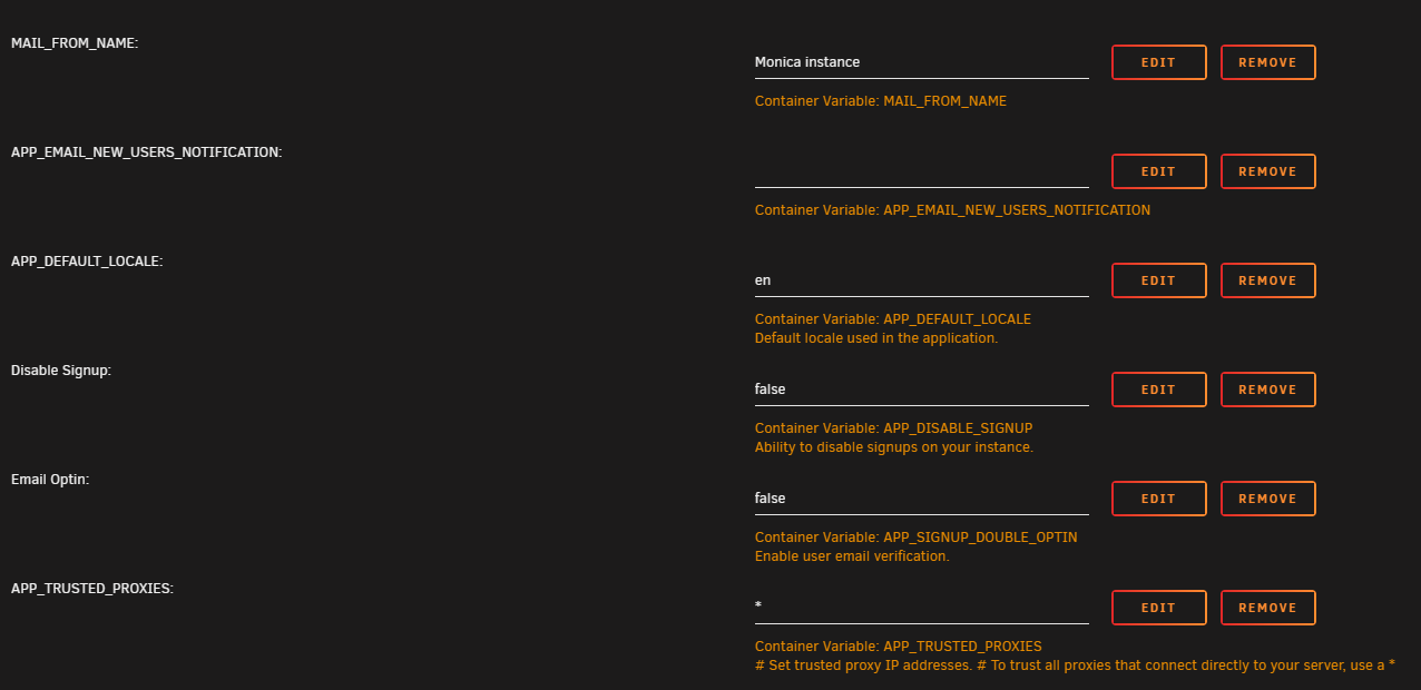

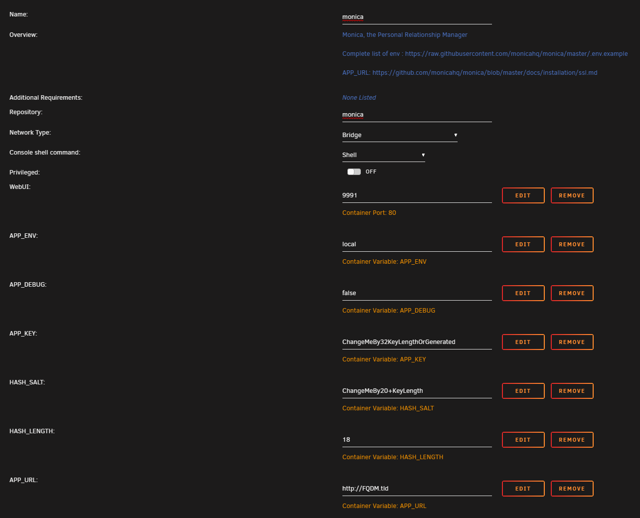

Could someone help me/ provide a guide on how to install Monica?
here is my set up:
I have a mySQL database (192.168.1.13:3307) named `monica`, but when I launch the monica docker , I get this in the logs:
Unable to contact your database
Despite my mySQL docker being active, and the port 100% being the right one. Any insight as to why Im not able to contact it?

the backblaze personal backup container directs here if you click support.  i try to start it but the webui does not respond.  the log says
[fix-attrs.d] done.
[cont-init.d] 00-app-niceness.sh: executing...
[cont-init.d] 00-app-niceness.sh: exited 0.
[cont-init.d] 00-app-script.sh: executing...
  any idea what is wrong
