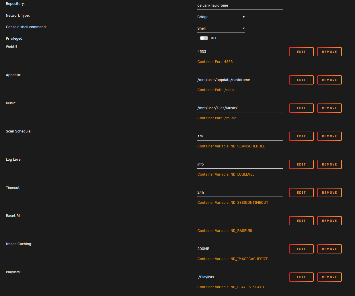

Hello. I've set up Navidrome but I can't get it to import playlists. The music directory is /music. I've tried setting ND_PLAYLISTSPATH to /music/playlists, ./playlists and neither works. Can someone give me a tip on what it is expecting for a path? Here are my overall settings. Thanks!
I fixed it. I used .:**/** with the variable and it picked them up immediately. Thanks.

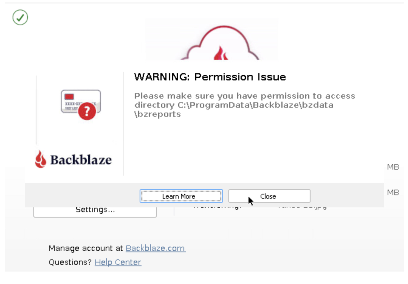

Using the backblaze docker, specifically tessypowder/backblaze-personal-wine:latest,  I keep getting this error message to check that I have permission access to C:\ProgramData\Backblaze\bzdata\bzreports (see attached). I've gone through and chmod the entire drive_c to 777...what could be wrong? Maybe I have too many threads running, I see this error whether I set performance to 100 threads or the recommended 8. Is this just soemthing that happens during long running backups? It has, and will be, running for days while I upload several TB of data...
Edited by Gex2501
typo
@Gex2501 I'm getting the same error. I've tried all the steps you have, also tried installing using all of the steps in the Github.  Did you have any luck getting it working?
My D drive is also not showing up in the container, but when I check using the steps in the github it shows the drive appearing as it should be in the terminal..
I followed the instruction on the github page and managed to get it working, can't remember if I did something not listed there. It seems to be backing up my files and operating normally. I just keep getting that error message. I've tried running the container as a different user or changing permissions from within the container console. The message just keeps showing up and I don't know why.
