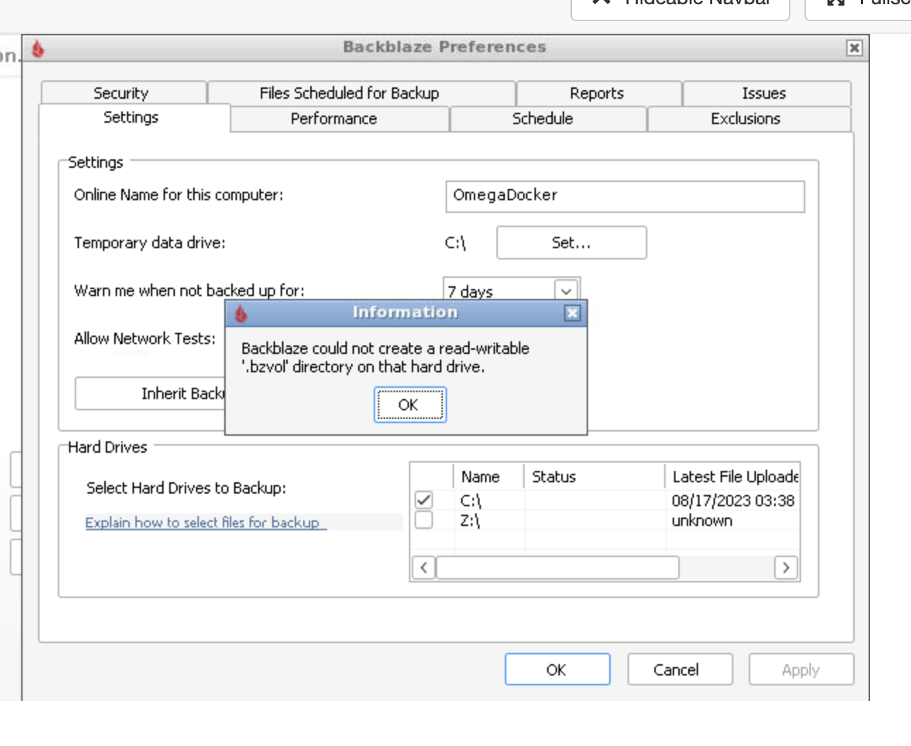

Hello,
I installed the Backblaze docker from tessypowder and I cannot see my shares or drives inside Backblaze. Am I supposed to map my shares somewhere in the settings?
When I try to check the Z drive on the attached screenshot, I get "Backblaze could not create a read-writable '.bzvol' directory on that drive."
I'm at a loss on how to backup my media storage on the array.
Any thoughts?
(Backblaze Personal Backup) I'm still unsure where I am making a mistake. I cannot get drive_d to show up in the GUI. I have C which is check marked and Z which cannot be clicked. I have "/mnt/user/HomeMedia/" in the edit page. I've reinstalled multiple times including deleting the Dockers folder.
W Unraid I almost never have issues but when I do it's usually due to mapping drives etc. How else can I get my data to show up so I can back it up?
Edited by bobvilla

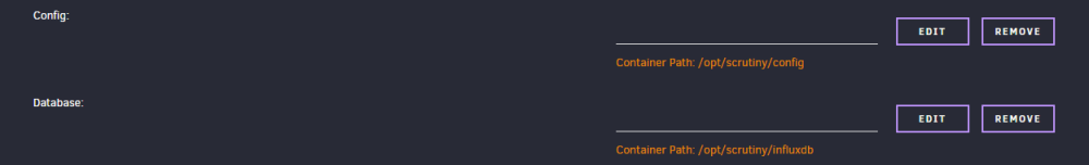

Can someone please explain for what Scrutiny has 2 rows in template?
And how I can populate them correctly? I most likely don't need them, but for educational purposes and full container functionality will be nice to understand

On 8/6/2023 at 11:34 AM, Beardown27 said:
Hello,
Any thoughts?
I'm hitting the exact same issue...
also for some reason its showing as drive Z not D
EDIT:
figured it out, i missed the installation step to do
`ln -s /drive_d/ /config/wine/dosdevices/d:`
in the docker. Now it sees drive D map directly!
Edited by Taako
My docker run command is
EDIT:
I remember that in the install but maybe I didn't do it correctly. Where did you place that line? In the extra param section? Thanks!
I went into the docker container itself and executed it. Click on the container icon, then click "Console". Execute within the window that pops up

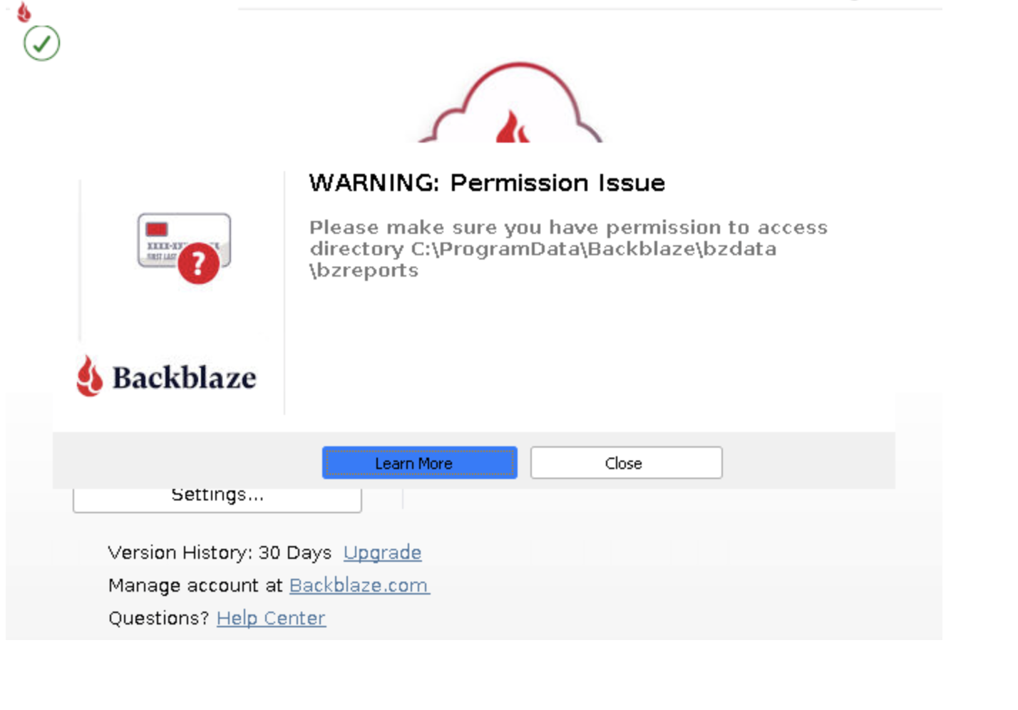

It seems there is still *some* issue and im not sure where if its going to be problemtic or not.
Whenever i start the server i get this error about permissions issue for C:/ProgramData/Backblaze/bzdata/bzreports
Does anyone know how to resolve this? Docker run command is that same as i posted in my earlier comment
im still seeing this pop-up frequently. Anyone know how to resolve?
backups seem to be working for my D drive
After fixing my drive_d I get these warnings too. I remember the first guide I followed when trying setup mentioned to put a folder in the exclusions tab but now I can't find that guide.
Check step 19 in this apps installation instructions.
i already have that step done and am still seeing the popup
