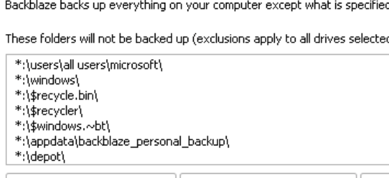

2 hours ago, Taako said:
i already have that step done and am still seeing the popup
Thought maybe I was in the clear but it keeps coming back to me too. :(

I think I'll pack this up. I got it working somewhat but now w that error popup I'm back at a loss. This is clearly an abandoned app. I guess I'll just buy an external HD and store at another person's house. This was 3 weeks of almost working. Good luck all.
for what it's worth the pop-up doesn't seem to prevent it from backing up
I thought I read a few places that every file you upload it creates a file in that folder? I need to check on that but if it's working maybe it's a non-issue.
If the plugin is otherwise working, detecting /drive_d/ properly, and everything in the Backblaze settings is set up like it should, the permission error popup is more annoying than anything else; if it's otherwise backing data up, I'd let it be.
i think the issue is we aren't sure what other symptoms are happening that we aren't noticing. The pop-up may be indicative of *some* issue that we aren't seeing immediately. It would be nice to address it
Also as an aside, Backblaze has a brand new Personal Backup tool coming out soon with (version 9.0), will this docker support that?

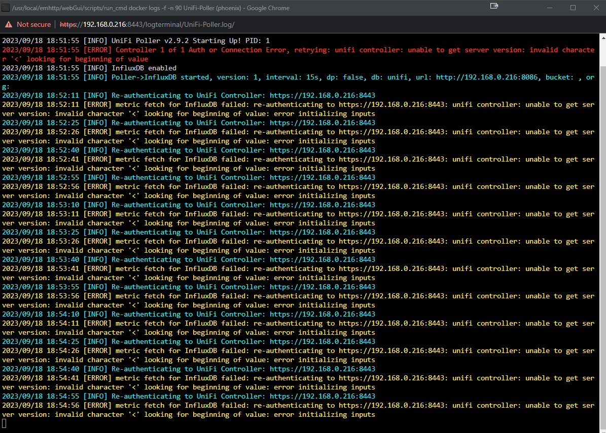

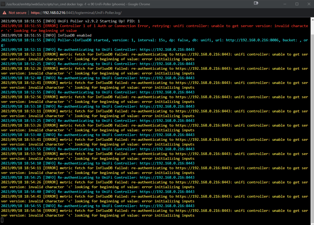

Unifi-poller quit working for me after updates this weekend. Looking above, there may be a significant delay for the version in the repository. I am using it in Docker and doing the Prometheus exporter. The logs suggest it's touching the Unifi controller, just that the Prometheus export is empty.
I just noticed an issue with my unifi poller as well.
Looks to me like its authenticating with my Unifi Controller successfully but attempting to parse data (the server version) in this case is failing.
If thats correct I'm guessing this is an issue with unpoller (I checked I am running the latest version v2.9.2).
