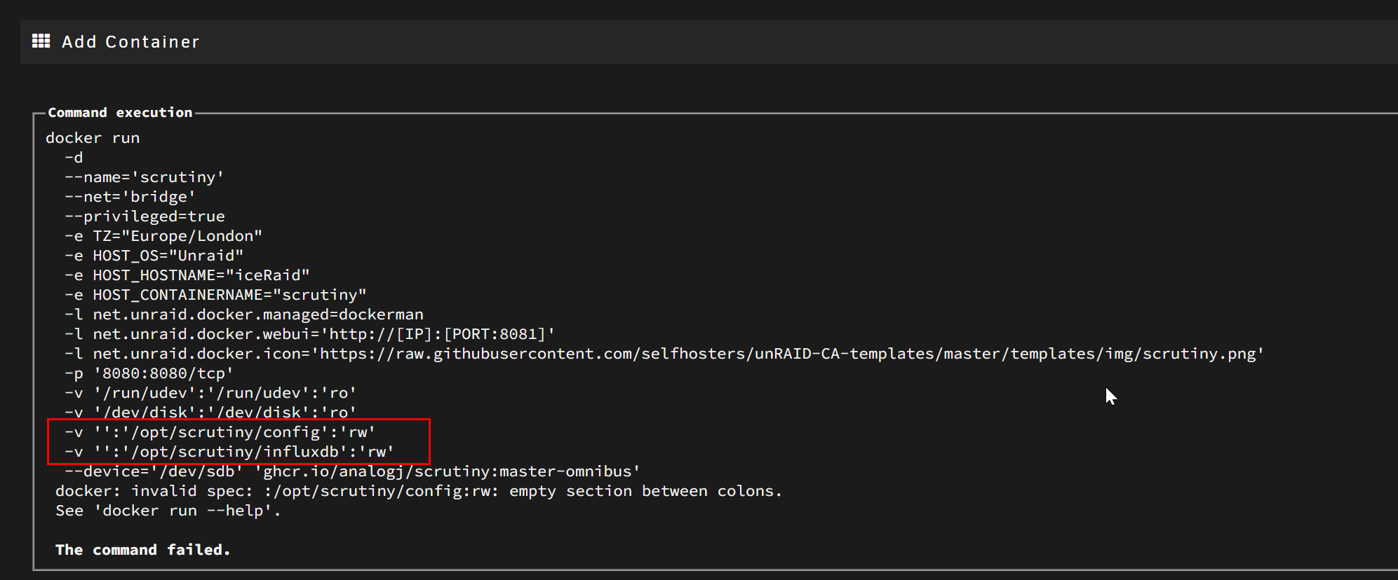

I am trying to install the docker 'scrutiny' - however, when the docker tries to install itself i get this error:
if I remove from the template the fields that add those two options the docker installs - having read about it, I believe the issue is related to the way the script is using 'pwd' to get a path - unfortunately, i don't know how or what to update to change this.
Is anyone able to help me on this?

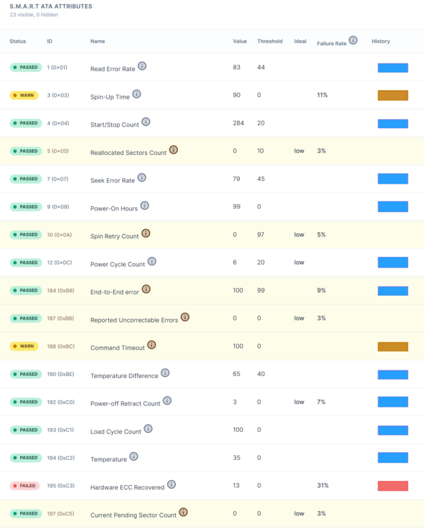

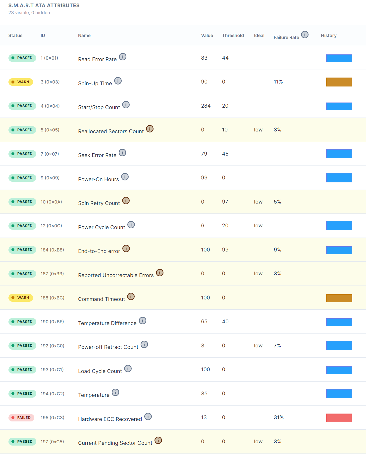

I've install a Seagate Exos 12TB HDD and Scrutiny gives false error about the drive Warning 188(0xBC) Command Timeout and
195 (0xC3)Hardware ECC Recovered.
ts-p500-smart-20240819-1747.zip

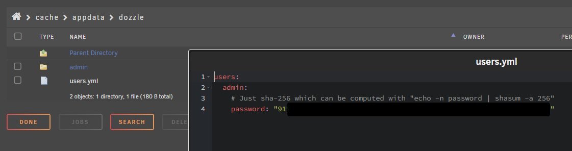

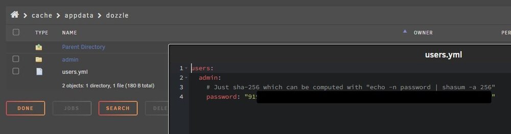

Since Dozzle moved to a nerw auth mechanism it's been unusable.  It requires a yaml file inside the container with credentials, but the container fails without it, and you can't create the file in the container since it fails, so it's a fail loop.  Has anyone figured out a way to run this?  The guides are decent, but assume you can start the container, which isn't possible.
Just create the file in your appdata folder as per container docs.
