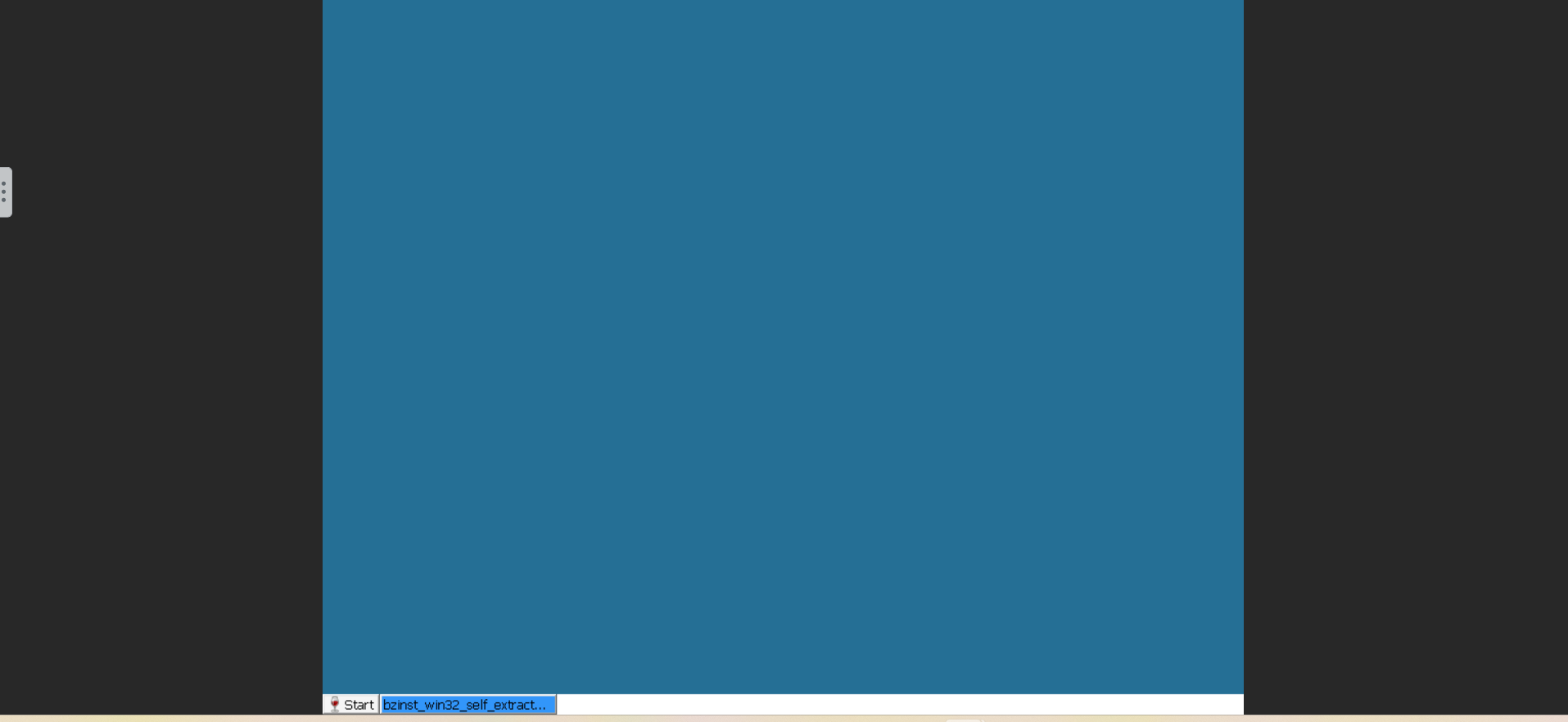

Has anyone run into this after install for Backblaze_Personal_Backup? Nothing happens if I click in the taskbar. I went into install apps and to c and tried to run the installer there as well. Nothing happens. The error log is empty.
Edited by tenletters
Yup, having the exact same issue...
Also having this issue, although I can't even see the taskbar.
Since it got updated the other day neither can I.
Re: Backblaze
Same blank blue desktop here, for the last couple of updates.
The pre-existing backup config is still working however - I can see upload activity from the docker, and Backblaze web account shows new data appearing as normal.
So - just a UI/VNC error it seems.
UPDATE:
Half-assed workaround - I found opening the *non* HTTP VNC address (usually port :5901) in a 3rd party VNC viewer caused the Backblaze app window to display.
After this has been done once, the `standard` Unraid HTTP web VNC (usually port :5801) will work thereafter.
The taskbar is still absent however.
Hopefully someone with more VNC-fu than me can work out whatever weird resolution/scaling/render hangup is causing the base issue.
Edited by kurai

On 3/10/2025 at 5:04 PM, kurai said:
Re: Backblaze
UPDATE:
I tried this and unfortunately it didn't work for me - other VNC viewers give me the same blank blue desktop as the one in my browser (Firefox).
