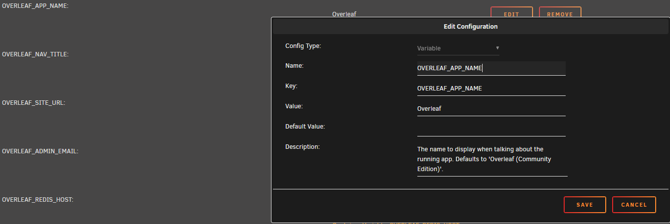

On 6/20/2024 at 7:49 AM, trauby3620 said:
 I have been trying to solve the issue on my own and figured out a way to fix it. Not saying it is the easiest or prettiest, but it seems to work (for now). So if anyone is having trouble, here are all the steps to set up a working Overleaf container in Unraid:
  1. From the apps-tab in Unraid:
    1.1  Install “Redis” (The default options should work fine)
    1.2 Install “MongoDB” (You can also use the default options, but don't forget to set Host Path 1 to your desired appdata location)Screenshot2024-06-18205228.thumb.png.d9009d18f419a8c39954dcd9db6ec767.png
    1.3 You probably need to add a database in MongoDB. Please refer to another guide for detailed instructions.
  2. Load the “Overleaf”-template from the apps-tab. Here, some modifications are needed before you can finish the install:
    2.1  All variables need to be edited to start with OVERLEAF_ instead of SHARELATEX_
    The result should look a little something like this:
    2.2 Optionally, you can add any of the options listed on the official overleaf git-page as variables: https://github.com/overleaf/overleaf/wiki/Configuring-Overleaf (e.g. I added the variables needed for Overleaf to be able to send emails)
    2.3 You must add the following path (by clicking on the little blue plus at the bottom of the template), to install texlive in a location that is outside your dockerfile. If you don't do that, 8 GB of data is being installed in your dockerfile, which is not recommended.
    Also add the following where we can save some commands later, that otherwise you would need to type manually after every restart of your server:
    Note: You might want to adjust the Host Path to point to your desired location on your array. The entry in “Name” can be whatever you like.
    2.4 Also optional, but recommended: free up even more space in your Dockerfile by adding the following path, which tells Overleaf to store the uploaded user data in the directory specified:
    2.5 Once all of these steps are complete: Apply the changes and finish installing the container. In the docker tab, you should now see the three containers we just installed.
  3. Create a file named “set_path.sh”  and add the following contents to the file using nano or a text-editor of your choice (I use Notepad++):
    export PATH="/usr/local/texlive/2024/bin/x86_64-linux:$PATH"
    chmod +x /mnt/user/appdata/overleaf/set_path.sh
    Hint: You might need to adjust the year in the first line.
    Save the file in the location set by the variable “PATH location” from step 2.3.
  4. Open the Overleaf WebUI and finish the set-up of Overleaf by creating an admin account like described in the wiki: https://github.com/overleaf/toolkit/blob/master/doc/quick-start-guide.md (replace “localhost” with the IP-adress of your docker installation or the domain you use for it)
    Once you finished the setup, everything seems to be working fine. But as soon as you try to compile a document with packages that are not shipped with the standard overleaf-container, you will see a critical error along with messages that certain packages were not found.
  5. To fix this, we need to install the full texlive-installation, by opening the Overleaf-console and running the following commands:
    5.1  Download texlive by typing the following command:
    wget https://mirror.ctan.org/systems/texlive/tlnet/update-tlmgr-latest.sh
    5.2 Install all texlive packages (This might take a long time, since over 4,000 packages are being installed):
    tlmgr install scheme-full
    5.3 Once the installation is finished, run the following command (most packages might work without it, but I had problems with biblatex):
    tlmgr path add
  6. Test if everything works:
    6.1  Go to your Overleaf-site and refresh the page (log in again if necessary)
    6.2 Create/Upload a latex-project which uses different packages like biblatex or microtype
    6.3 If the compile works without any critical error, you are done!
Hope this helps, and you can install and use Overleaf without any problems. If you have any suggestions on how to improve the procedure, feel free to reply and let me (and the others) know.

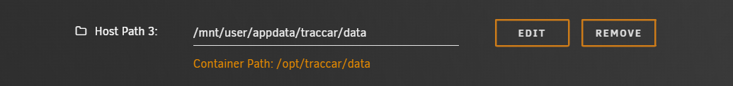

On 3/24/2025 at 11:49 PM, Bfox135 said:
Hey, I noticed it was mention in a older post but wanna bring up again.
Traccar is missing Volume path.
This needs to be added or else Traccar deletes the database when it updates.
I had it happen twice now thinking it was a fluke but the docker container was missing this path.
--volume /opt/traccar/data:/opt/traccar/data:rw \

On 3/27/2025 at 4:21 PM, matt21572 said:
Do I install that in the traccar.xml file
BTW i have been looking at how to fix this for weeks.l your a lifesaver
sorry for the delay but you have to add a new volume path.
this is what I did to fix it.
