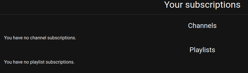

Updated the latest nightly, and again, all subs are gone after the update. Which db file in the appdata is supposed to hold sub data? The db.json file has this
 "subscriptions": [],
I've attached the dropdown on one of the videos, no "go to subscription" present.
The info gives what looks to me a normal result
The subscription page

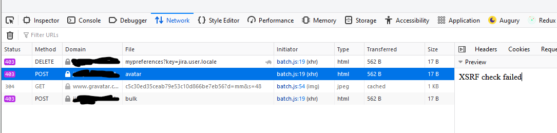

I'm trying to setup jira (god help me) and I'm a little stuck when using NGINX Proxy Manager.
I have my url in the Reverse Proxy Entry in the template, and NGNIX Proxy Manager setup to reverse proxy the container. I get into it fine from the outside using the url but any posts or deletes will generate the XSRF check failed response. Thus I can't even get past the initial step of creating a project.
Can someone let me know how I should setup NGINX Proxy Manager to handle this?
