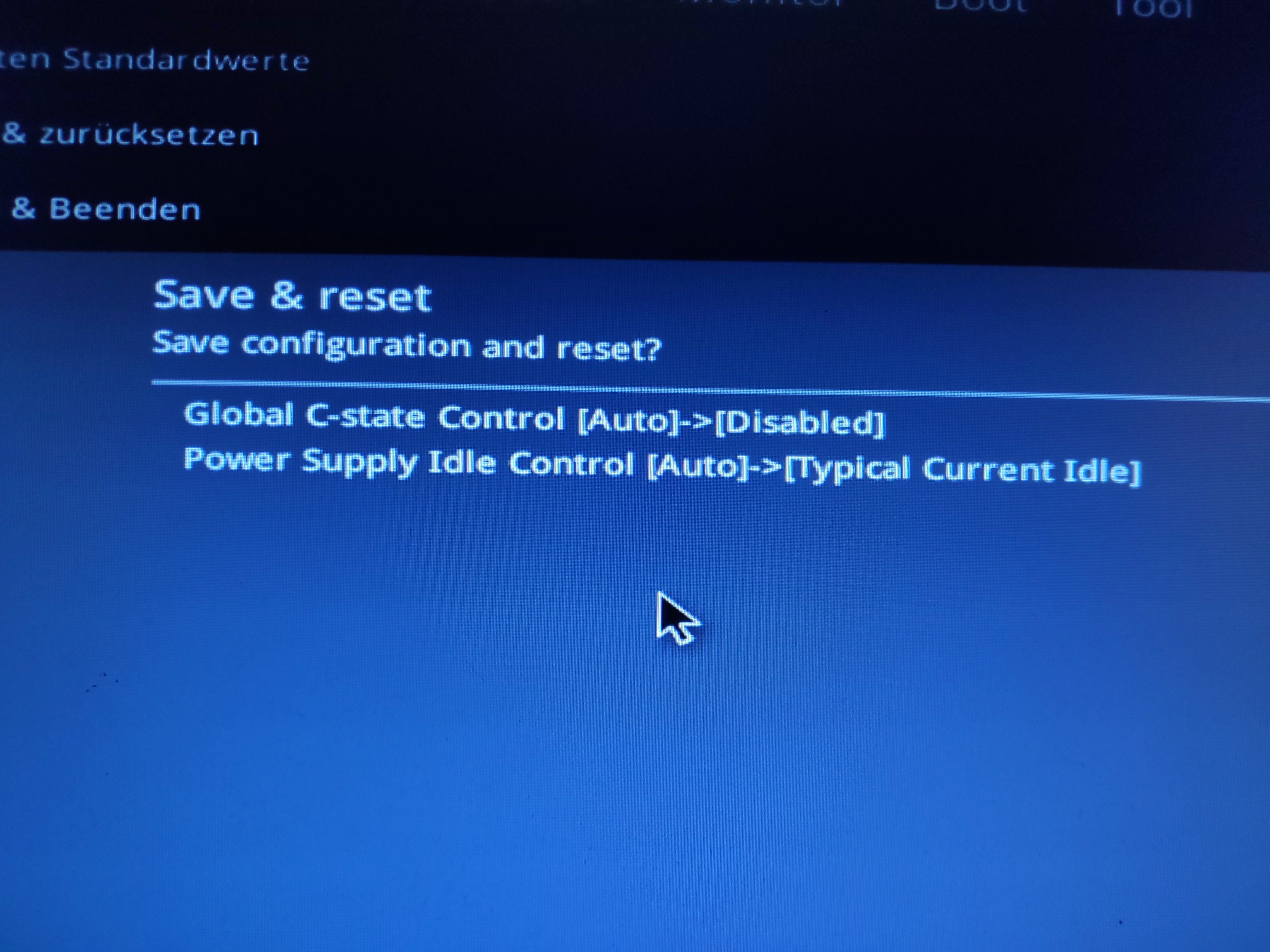

28 minutes ago, johnnie.black said:
Ryzen based CPUs on Linux can lock up due to issues with c-states, make sure bios is up to date, then look for "Power Supply Idle Control" (or similar) and set it to "typical current idle" (or similar), or completely disable C-sates.
More info here:
https://forums.unraid.net/bug-reports/prereleases/670-rc1-system-hard-lock-r354/
I will try.. i hope this also fixes my lost vm and docker issue.
With power supply control set correctly you can usually leave c-states enable.

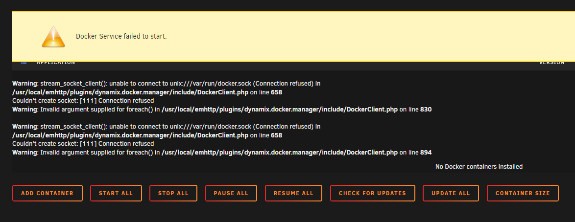

after changing the bios settings i tried if this fixes my docker / kvm problems.. i reinstalled the docker containers and tried to install a debian vm. After some working with the vm i ran into the following issue again. I think after a restart there is no more docker /vm like before.
Maybe it is wrong to install the docker into appdata which uses my cache SSDs?
Docker Tab:
VM Tab:
tower-diagnostics-20200126-1059.zip
The diagnostics show that your cache is failing to mount which could explain both your docker and VM problems.
Cache drive filesystem is corrupt, you need to reformat, but before that run memtest, various apps are crashing/segfaulting, very likely you have a hardware problem, like bad RAM.
