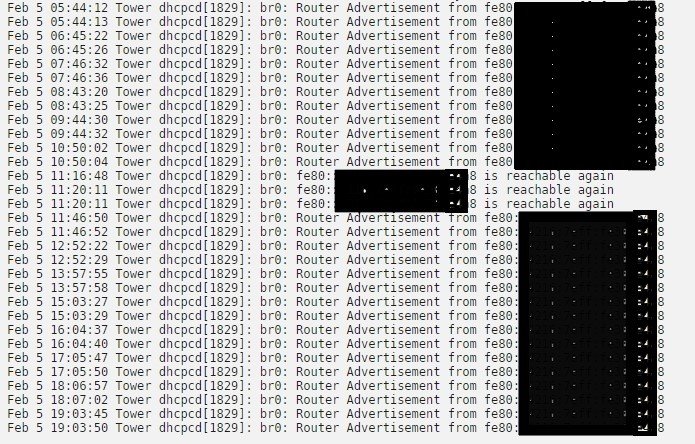

I see these Router Advertisement, with 6.8.2, does anybody know how to suppress them? I wasn't seeing these with version 6.7.2.
Edited by dianasta
