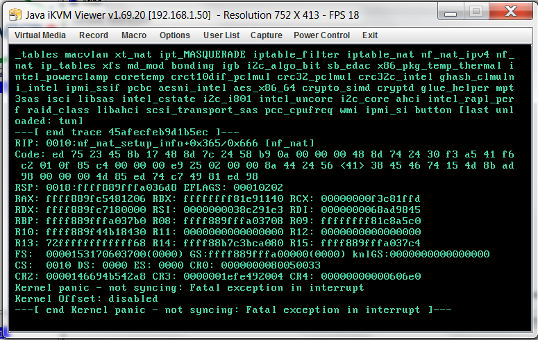

Panic message when the server locks up.

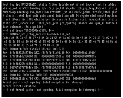

Another crash from a different day.
